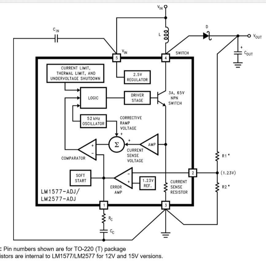

I need to find a supply that uses a IC where I can get to both inputs of the error amplifier. Too much technical. Normally there is an amplifier that looks to see if the output voltage is good. Normally one input goes to a good reference voltage. (1.25v or 2.5V or 5V something good and stable usually built in side the IC) The other input of the amplifier looks at the output voltage through a resistor divider. Your 3.3V output is divided down to match the reference voltage.
The 1/3 ides is to remove the reference voltage and replace it with (1/3 Vin). So the IC will be working to make Vout = Vin/3. (not normally what a pwmIC does)

Here is a typical buck power supply. Look at the error amplifier. It compares the output voltage to 1.23 volts. Some parts allow the use of an external voltage reference. We need to use 1/3 of vin as the reference.

Incase some one is following this. The Chinese buck supplies use many different ICs. Some are the MC34063. The older IC uA78S40 is the same thing but in a bigger package. The 78S40 will do what we want but the Chinese do not use it. I was hoping to fine a $3.00 supply that could be easy modified. Will keep looking.

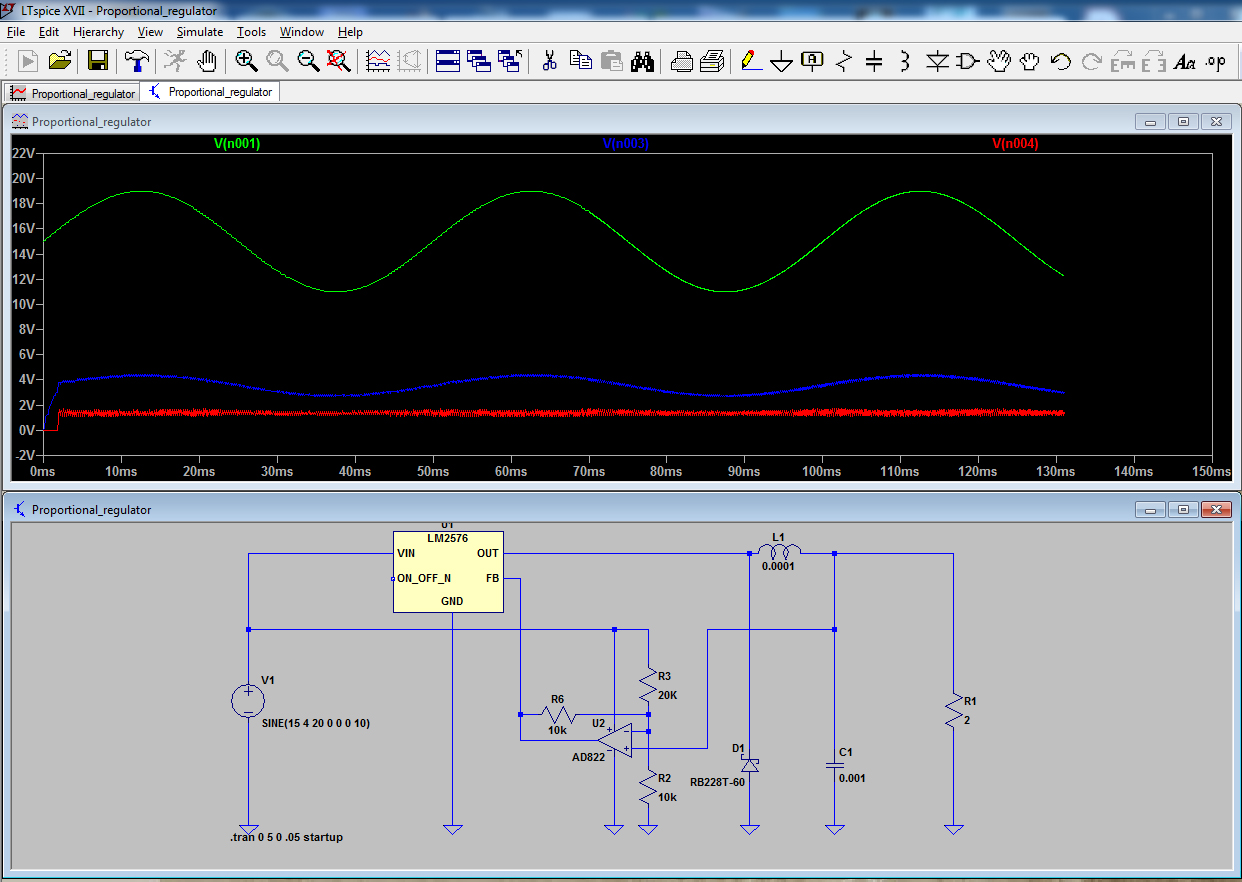

This is purely to prove the idea and not a final design, but it seems to work - add an opamp to compare a fraction of the supply to the output & feed that to the sense pin on the regulator, with appropriately low gain to prevent oscillation.
I've not included the .asc as the LM2576-5 is not the ideal part & the model I found seems a bit odd, but it's nearest I could find to the LM2577 example. It really needs a .adj version. The opamp is just picked pretty much at random from the ltspice library.
Green = input, blue = output and red = feedback.

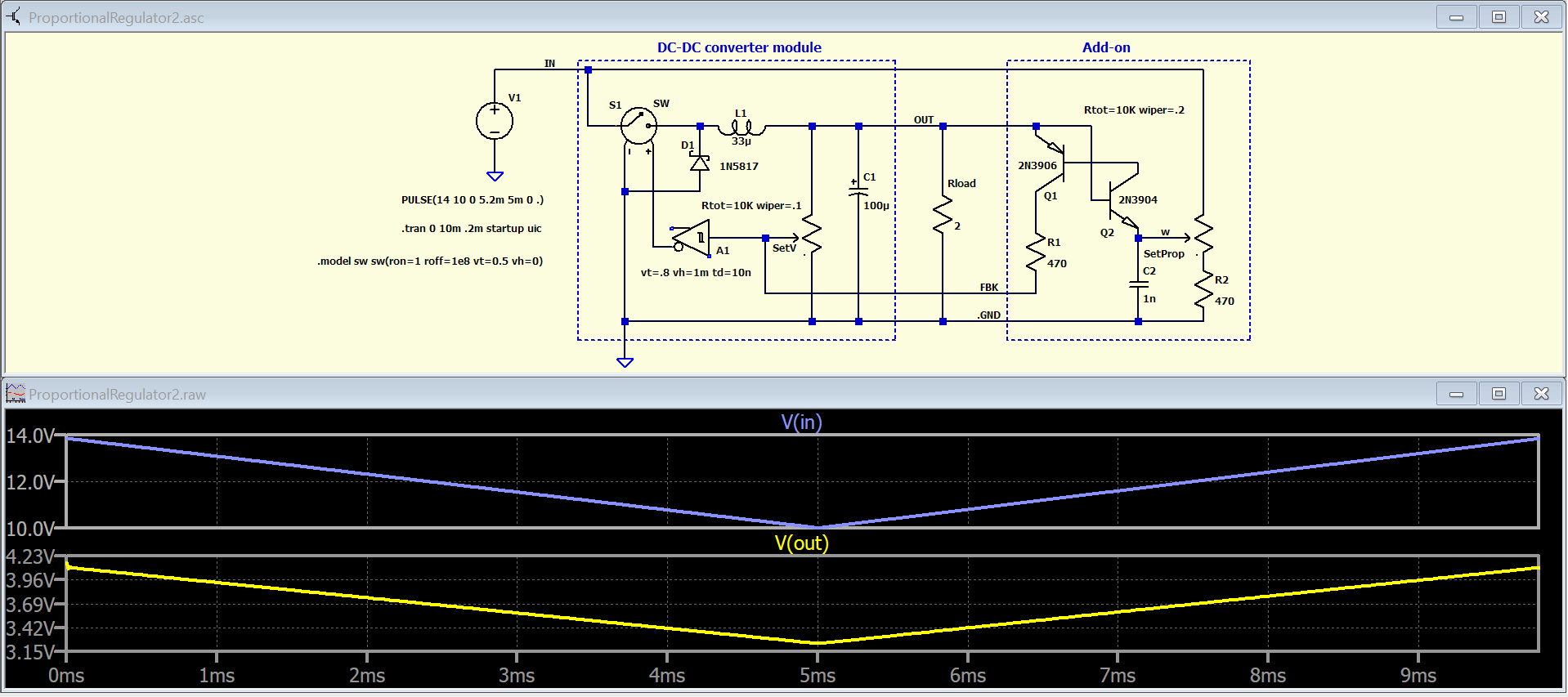

Here's a sim of an alternative adaptation of the ubiquitous Chinese DC/DC module shown in post #14, which doesn't need the module's pot to be disconnected and doesn't require an opamp.
The left-hand dotted rectangle contents emulate the DC/DC module.
The output voltage is the lower of (1) the voltage set by the SetV pot in the module and (2) Vbe + the desired input voltage fraction set by the SetProp pot in the add-on.
The add-on connects to the wiper of the SetV pot to provide feedback.
R1 and R2 are current limiters in the event that either pot gets cranked to its zero Ohms end.
