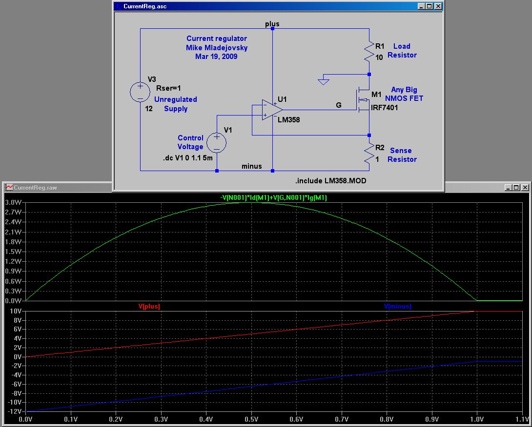

So guys can anyone suggest any ideas for a 50-800mA regulated current supply for a 10 ohm resistor, 10 volts output at max?
...can anyone suggest any ideas for a 50-800mA regulated current supply for a 10 ohm resistor, 10 volts output at max?
Here is a current regulator which has a very low drop out voltage. Its output current is proportional to a control voltage; 1V produces 1.0A in the 10 Ohm load. In the LTSpice simulation, the independent variable (plotted along the X axis is the Control Voltage.
Note the peak dissipation in the FET, and in the Sense Resistor. The minimum input voltage is only 11V!

I appreciate that, but my load has to be grounded. it cannot be a floating load. in your design the load is between the supply and transistor. can i use a pfet instead on nfet?
Yes, but the Control voltage is referenced to the positive supply. How about this?
