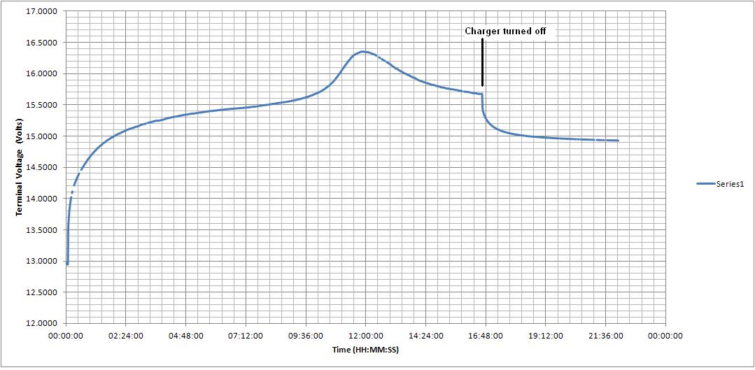

To emphasise AGs point, have a look at the attached graph.
It is a graph of voltage against time of a battery of eleven F size NiMH cells charging at about 1 amp.
Note how the voltage falls away when the charger is switched off, an exponential decay over several hours.
