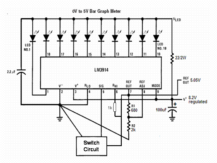

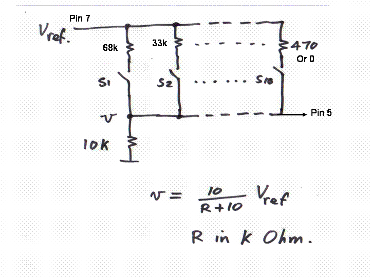

Everyone seems to be assuming that the resistors have to be in series. They don't. If in series, there will be cumulative error.
The spreadsheet shows the voltages at pin 5 of the LM3914 for each resistor value. I have not included the resistor tolerances. I suggest you use 1% ones.
The circuit on page 2 of the National data sheet for the LM3914 is relevant.
Note that the motor bike alternator is likely to give large spikes. So I suggest you have a resistor/Zener regulator. Use an 8.2 Volt Zener.

Hi Len,
Thanks for the spreadsheet with exponential resistor values. Why did you select voltage levels at each step that are 0.25V too low?
I sketched the voltage reference setting and a few other things:

G'day Audio,
Why do you think the voltages are 0.25 V too low?
The point is that the comparitor reference levels are set at 0.5 V intervals (assuming a 5 V reference) so the switched levels should be about half way between. Otherwise, the transistions will not be "clean".
I have also realised that the tenth switch needs to be at the high end and a 1k resistor is required between pins 6 & 7 in order to shift the reference voltages down a bit. The last (10th) switch does not need a resistor.
Len
Edit, here is the revised circuit & spreadsheet

Hi Len,
Before your switch points were 0.25V low which would cause the LM3914 to indicate one LED too high. Now the switch points are 0.2V high to ensure the correct LED lights regardless of resistor tolerance.
The LM3914 switches cleanly, its switching isn't abrupt but sort-of slowly fades in or out the next LED.
The gas in the tank will be sloshing all over the place so the input to the LM3914 will need a filter to average it. The filter will also help a little to hold a reading if the switches are break-before-make with a wide gap in between. :lol:

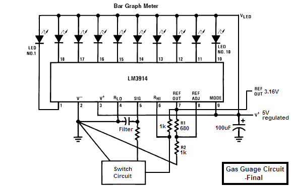

Hi Trevor,
Since you are using a supply of only 5V for the LM3914, its reference voltage must be set no higher than 3.5V, since its max dropout voltage is 1.5V. The closest that common resistors give is 3.16V which will work fine.
I have added everything to the circuit to make it work properly for you. :lol:
It's too bad that Len's sketch was full of dots.

Audio. I'm very grateful for this - way over and above the call of duty! Many thanks indeed.
I'll hook it up and post the results hopefully with a photo or two of the entire project when it's finished.
Trevor

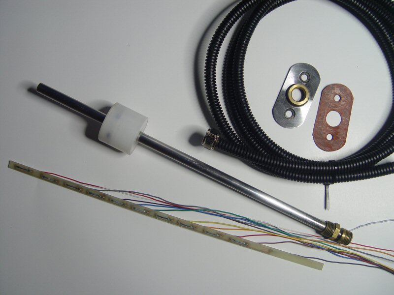

Hi Audio
It's been quite a while since you helped me with this. A lot has happened since then and the project got set aside. I retired for one thing so needed to sort a few life style problems out. Anyway, I'm beginning to pick up where I left off and I hope you won't mind me coming back to after such a long time for a bit more advice.
I've managed to complete the tank float assembly (see photo) including the setting of the reed switch positions - each one turns on at each increment of 1.5 litres of fuel. There's a "dwell" of about 8mm as the magnet traverses the length of the reed switch and then it goes off. This was an interesting challenge as I had to use a spare tank and 15 litres of fuel poured in at 1.5 litres at a time and the height of each switch measured.
As was pointed out in previous posts, there's the question of the gap when the magnet is between each switch when no switches are on. This turns out to be about 10mm. You allowed for this in your schematic that you drew up for me with the capacitor/resistor filter. Can you tell me how I decide the values? The problem will be when the bike is unused for any length of time with the magnet between switches. Won't the cap discharge and result in no display when the ignition is turned on again?
Once again, many thanks for all your help.
Trevor Rymell
