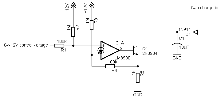

I am hoping someone will be able to assist me with this circuit.

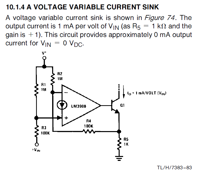

I am looking to control the rate of discharge from a capacitor with voltage. I have tried to implement a voltage-controlled current sink as per the LM3900 Norton Amplifier datasheet:
currentsink-png.70287
In essence, I want to be able to voltage control the rate of decay of a simple voltage envelope generator made by charging and discharging a capacitor.
Ideally,
Less voltage = longer discharge
More voltage = faster discharge times
I experimented with this circuit a bit without the capacitor and got consistent results from 0mA to approximately 10.5mA when using 0-12V voltage control, all good so far! That was measured with my multimeter.
But, when I connected the capacitor and charged it, then used the LM3900 to sink current from it, all sorts of interesting behaviour happened. The LM3900 seems to discharge the capacitor to a certain voltage, and then stop. I can vary the end voltage it discharges to by varying the voltage input.
Can anyone shed some light on what is happening here, or what I am doing wrong?
Thanks so much for any help :)

The principal seems ok. What does your circuit look like? What size cap, voltage and discharge time are you looking for?
The circuit can't discharge the voltage at Q1's collector below the reference voltage at the plus (+) input of the op amp.

Hiya! Thanks for the response.
Here is the basic circuit I am working with. The capacitor is charged by a quick trigger pulse and then the trigger is removed, allowing the cap to discharge. The idea is to have the discharge rate voltage controllable.
Ahhh! I figured it might be something to do with the voltage, as the voltage it would discharge to seems to vary with the voltage at the input.
Okay, so given that, do you have a clever suggestion as to how I can overcome or counteract this feature?

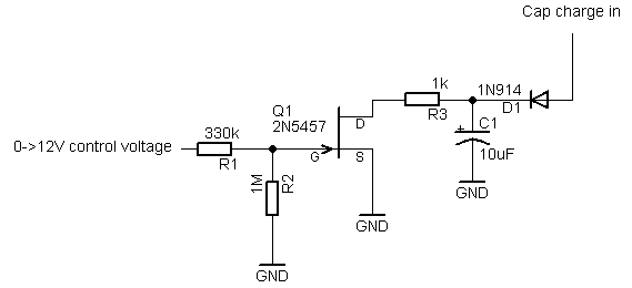

You could use a FET to discharge the cap, as the FET D-S will act like a resistor, and the resistance is based on the FET Gate voltage.
It won't be a perfectly linear relationship of gate voltage to resistance, but it is adjustable and might suit your needs.
Then of course you could just use a pot to discharge the cap, and adjust the pot?
Reducing the value of R5 will reduce the minimum voltage for a given current, but you obviously can't reduce it completely to zero with that circuit.
If you connected R5 to some negative voltage, then you could discharge the capacitor to zero volts (or below).

Okay, I'm back at it again. I have tried a 2N5457 FET configured as a voltage controlled resistor, but the results aren't what I would like.
There is not a really large amount of adjustment. Doing some tests from the drain of the FET to GND without the capacitor connected shows resistance adjustment from about 70R to 300R, which is not enough of course.
I need discharge time adjustment via voltage control of about 10mS to approximately 1 second. (give or take).
Here is the schematic as it sits currently. I must be doing something terribly wrong here! :confused:
Thank you for any help, gentlemen!!!
Thanks for the response! I tried connecting R5 to -5V instead of GND, but it still seemed to function the same. Hmph...

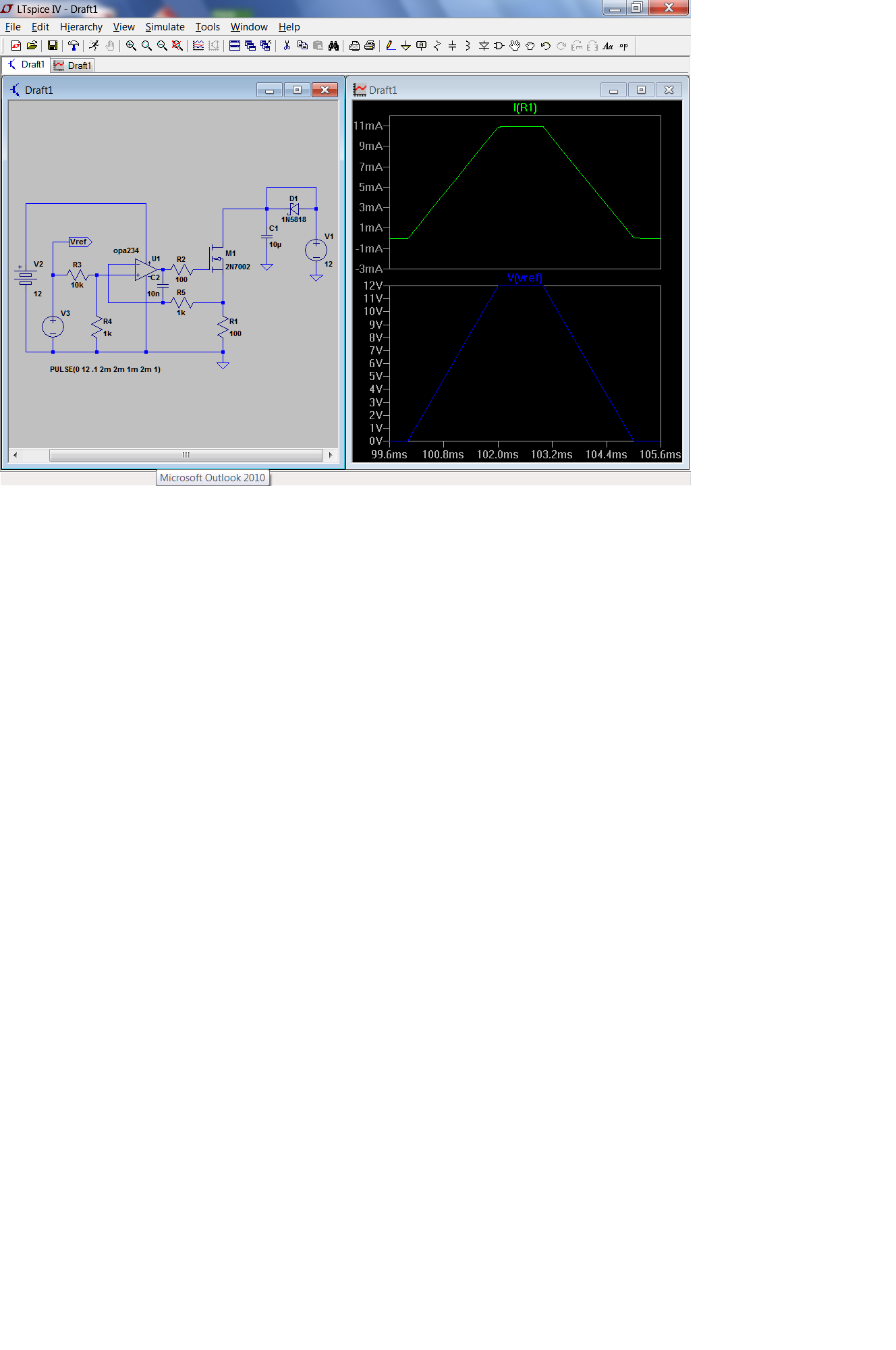

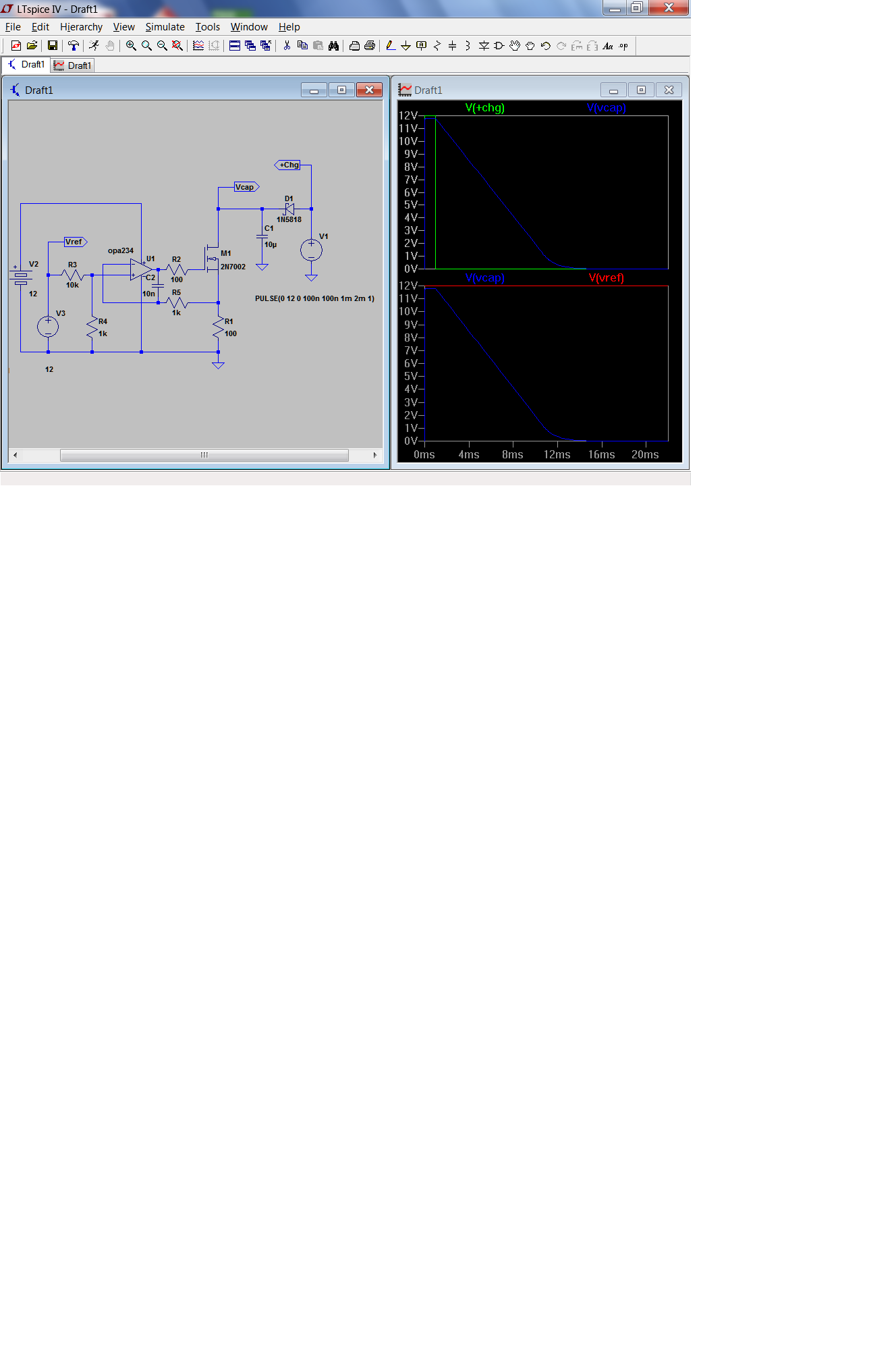

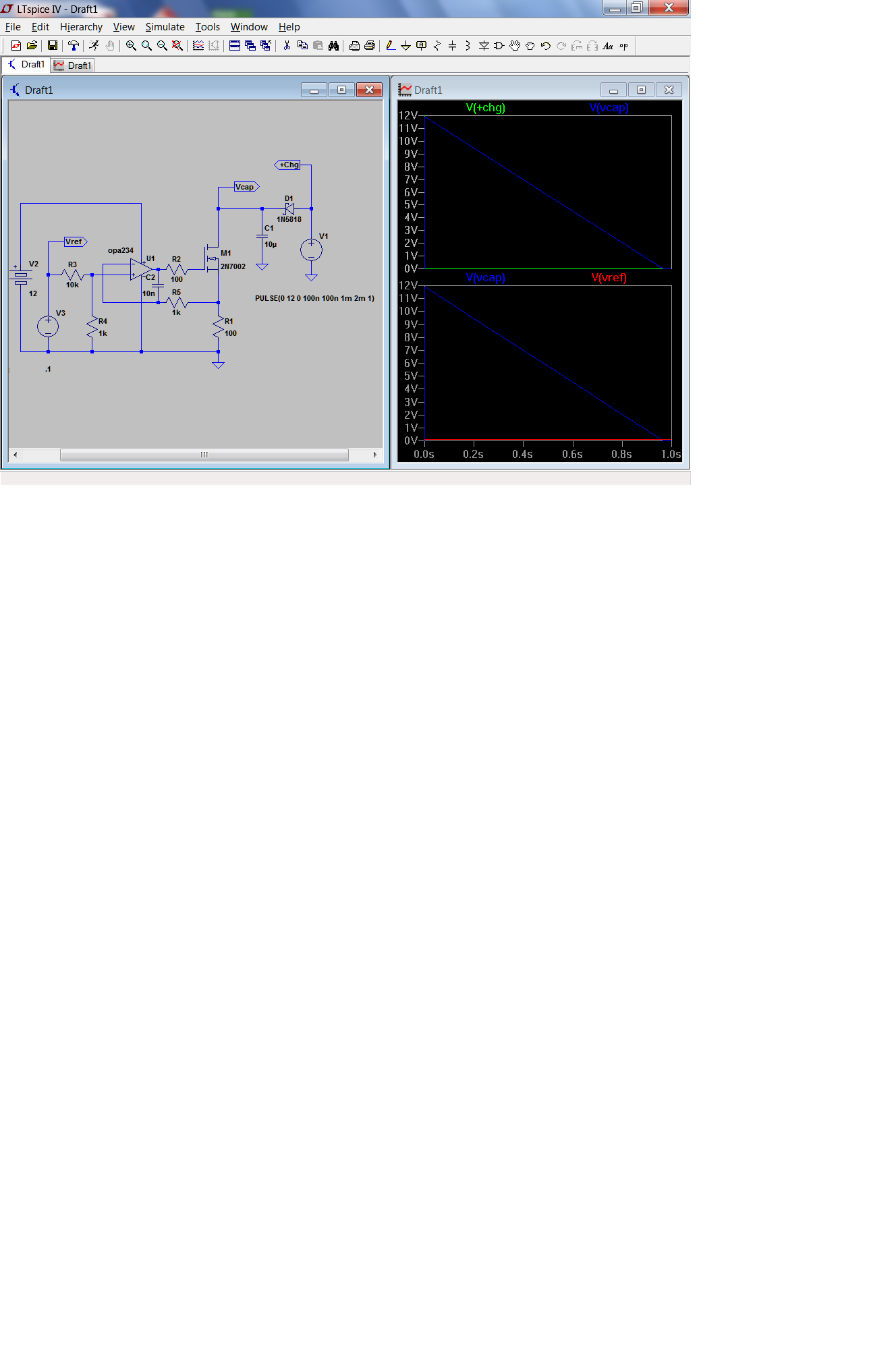

Maybe something like this?
Okay -- I have tried this out and it appears to work for a short duration. After awhile though, the circuit begins to malfunction and the opamp starts burning up. Any idea why this is happening? I've looked over the circuit a few times and do not believe I breadboarded it wrong.
I am using a TLC272 single supply opamp and a 2N7000.
Thanks for any insights!
Is it just like the schematic or maybe the divider on the input isn't there?
