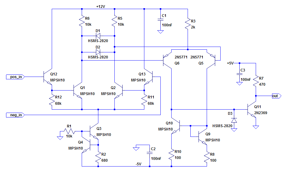

I am building a circuit that incorporates a lm311 as a voltage comparator. I need to replace the LM311 IC with a circuit that is completely discrete. By discrete i mean, resistors, fets, transistors, diodes...etc.
I have seen a few circuits on the web, but they incorporate over 20 transistors, which might make things a bit difficult. IT doesn't have to be perfect but work decently in my successive approximation a/d circuit and i think i am making thing more difficult than they should be.
I am guessing a circuit thats based on a basic differential amp would do the trick but i am not sure.

Well The project is to build a A/d converter. I have already pretty much built the converter with the lm311 IC for testing purposes, but one of the specs/rules is that no ICs can be used and only discrete components. The only exception is the 74 series digital ICs may be used.
So in short i am now looking to replace the comparator with a simple discrete circuit.

Here is LM311 with discrete components of course you need lot of transistors.

Look at datasheet for LM393.. its a comparator with not too many transistors.
Doing a discrete A/D converter that works well is no easy task. Your professor is being silly by making you build comparators out of transistors.
I posted a comparator circuit for you here. You never said what was wrong with it. It has 11 transistors. You need lots of trannies because you need high gain, high speed, low offset, good temperature stability, etc.
I simulated that circuit before I posted it, and it should work for you. I'm frankly pissed that you are asking the same question again without as much as a thanks, go-to-hell, or anything.

Hey Roff whats with the RF transistors, can one use standard 2n2222a and hobby type PNP transistors or do i have to use those listed on the schematic ?

I tried substituting 2N3904 for all the NPNs, and 2N3906 for all the PNPs, and then rerunning the sims. It might still work at 100kHz signal bandwidth, but I doubt it. The propagation delay is way too long. You need delay times of considerably less than a microsecond, because your clock rate is around 1MHz. The DAC and the comparator combined have to settle in less than a clock cycle. I also doubt that your 10k R2R ladder will settle fast enough.
