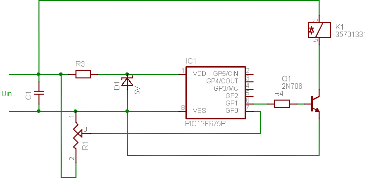

Here's an example, you need to program the PIC with correct code...

Do you know PIC's ? This is an ideal task for PIC, really cheap and simple.

Well it depends, I know PICs and it is easier for me to do it with it. Also, using PIC you can add more features to your design, such as Acustic or LED signalisation or controlling of more inputs, everythink using one 8pin device!

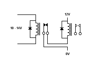

You can use a small relay, a reed relay for example, with normally closed contacts as the 10 to 1V detector. (A 12V relay will operate on this range.)
When it is energised its contacts open and switch off the other relay.

Because a PIC will be able to latch. If you do this relay to switch off a load, it will switch on/off, on/off, on/off endlessly.
You could also make the relay coil's circuit powered from the contacts, but then you'd need a button to turn it on in the first place.
The coil itself is not very useful as a voltage detector, though it does have good latching behavior. Where it turns on or off is not well specified and varies with temp & vibration.

Well, I still think PIC is better comparing to OPamp + relay, remember PIC is just 8pin device... But I agree that it's not suitable for beginners.
