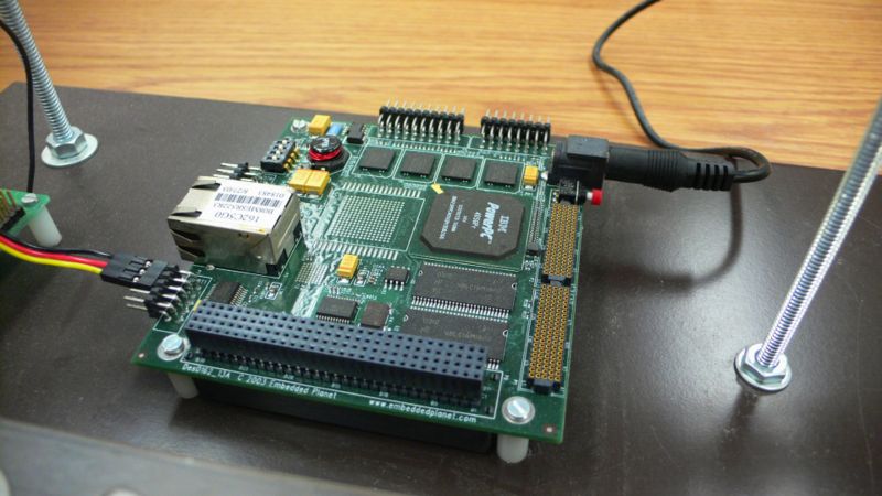

im making a voice controlled wheel chair for my final year project using matlab. The problem is it contains heavy computing so it is very difficult for me to take it to any microcontroller on C+ or assembly language thats y i want to know that is there any processor or microcontroller available that can accept matlab code directly ?? i heard of audrino can audrino take the matlab code directly??? Please advice someone
One solution is build a small computer system using the PC/104 form factor. Nice and compact. You can transfer stuff done in c+ and compiled on an ordinary PC directly to the small computer. You might possibly be able to run matlab on the small PC directly if you get it with enough memory and load window's embedded operating system on it, but I would think you should rather compile your code and run as an executable on the small PC. Good questions to ask the manufacturers of the CPU boards, or go to their website's Q and A area.
Here's what a CPU board looks like. It's about 4 inches square. It is essentially a complete mini x86 PC. Peripheral boards can be stacked on top or underneath.
PC104 is a good mobile platform. You can get really complex motherboards, and lots of options on the IO boards.
