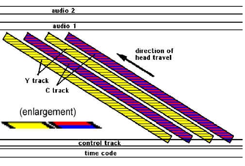

The video recording head is not a simple thing. In audio the tape passes the head at a constant speed. In video the head spins. From the picture below you can see there are two audio tracks a control and a timing track that are much like audio recordings. You could use these as is. The video tracks give you two tracks per line of video. They run at a angle on the tape. This is why I was taking about 15750hz and using about 80% of each time block. To use the high speed recording part of the tape you need to match your data to the spinning of the head.
Why does the head spin? The magnetic partials on the tape can only be made so small and the gap in the head can not be made much smaller. So to get high speed recordings the tape needs to move fast. The video tape only moves fast enough to record the audio (15khz). The video in the mhz range needs to move 500 times faster. The head spins and by adding the speed of the tape and the speed of the head spinning the speed is very fast. (4 to 12mhz)
I would use the recorder as is. The record and playback amplifiers are complex. The timing is complex. You could start out by recording on the two audio tracks just like a very good audio tape. Then later try recording data in the two video tracks.
