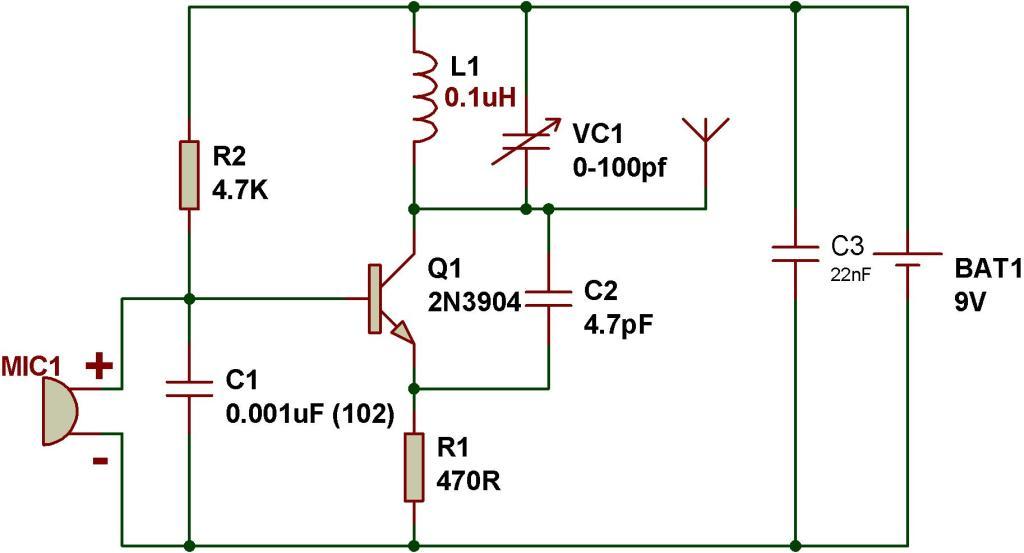

I had some free time available this week, so I decided to take a break from my AF projects, and do some RF experimentation.
I've never done anything RF related on my own (appart from a very simple AM receiver, based on a germanium diode), so I found interesting and exciting building a simple FM circuit, and see how it works.
With this one I didn't get a nice sinusoidal oscillations.
I needed to replace the 4.7pF with a 10pF, or even higher.
Anyway, even though I managed to get some 90 MHz oscillations, I could hear its signal using an FM radio across a broad frequency range (more than 5 MHz). So it seems to be not very stable.

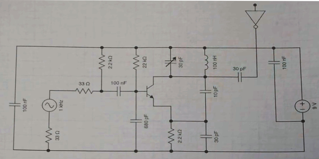

Then, tried ideas from:
The increased base resistor to supply voltage improved things, but the capacitor from emiter to ground just didn't work.
The collector-emitter capacitor has a great impact on frequency, not just the variable capacitor, which has minimal effect. This doesn't make much sense to me.
I'm building the circuit on a small solderless breadboard, using very (very, just minimal) short wires.
If I had to draw some conclusion from my couple of hours experimentation session, I'd say that these simple circuits just can't transmit at a very precise frequency, so they are not really suitable for me.

Audioguru posted a circuit he designed. If I look at the second transistor stage, it seems very similar, and I'm sure this one works well...
I'm not interested in good sound quality, and definitely not looking for a complex project, but just some circuit fun to fill spare time. So simplicity is priority. Just a circuit which can transmit a precise frequency (at least, which could not be heard over megahertzs!).
Is this possible, or should I have to go for more complex designs?
That is likely to be your problem.
The simple circuits are susceptible to:
supply voltage variations
stray capacitance variations due to nearby objects
physical disturbance of their components
Your FM radio is probably cheap and was extremely overloaded by the strong very close-by signal from your FM transmitter. My cheap Sony Walkman FM stereo portable radio has a local-distant switch. On "distant" them my FM transmitter and all local stations are all across its dial but on "local" it is not overloaded but cannot pickup fairly far away stations. My FM transmitter also overloads my cheap clock radio but my hifi stereo radio and car radio are fine with no overloading.

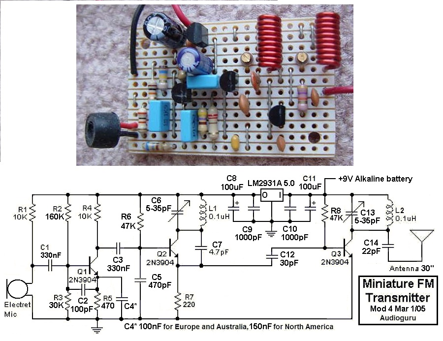

My FM transmitter was a "fix" to a circuit similar to the one you found. It uses a low dropout voltage regulator so that its mic preamp works fine and so that the oscillator radio frequency does not change as the battery voltage runs down.
The frequency changed when something moved towards or away from the antenna since it originally was connected directly to the oscillator so I added the RF amplifier output transistor to isolate the oscillator from capacitance changes at the antenna.
It has pre-emphasis like all FM radio stations have that matches the de-emphasis that all FM radios have then it sounds perfect.
I agree that a solderless breadboard has too much stray capacitance between all the rows of contacts and cannot be used for RF.
So, there're two variable capacitors. How should I tune the RF amplifier's one?

The RF amplifier tuned LC in my FM transmitter has a broad bandpass. I tune it for the most distance at the frequency tuned by the RF oscillator.

Here is my FM transmitter for people to see what we are talking about:
Shouldn't both oscillators be tuned always at the same frequency?
Do you requiere an oscilloscope for doing this?
There is only one oscillator to set the radio frequency. The tuned LC circuit at the antenna is on the RF amplifier that isolates the oscillator from capacitance changes at the antenna. This output LC is tuned for the maximum output power (maximum distance).
I am adjusting the output tuning capacitor and on the phone with my wife who is driving away in the car. I say, "Is the signal stronger or is it weaker now?" and keep adjusting it for the strongest output power. My oscilloscope does not go as high as 100MHz.

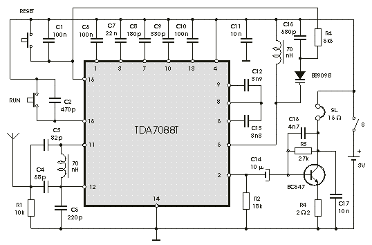

A radio contains IF transformers and/or crystal filters that are probably not available. The cheap FM radios that I have use a single IC but many capacitors.
Do you want to make a ham radio transmitter and receiver or do you want to make a child's walkie-talkie?
Here is the schematic of the cheap FM radio. All the parts are available but it has two inductors that you might make yourself. Look at all the kits and projects on this website. It has a few language errors so it might be on the other side of the world.
https://electronics-diy.com/fm-radio-receiver-using-tda7088.php

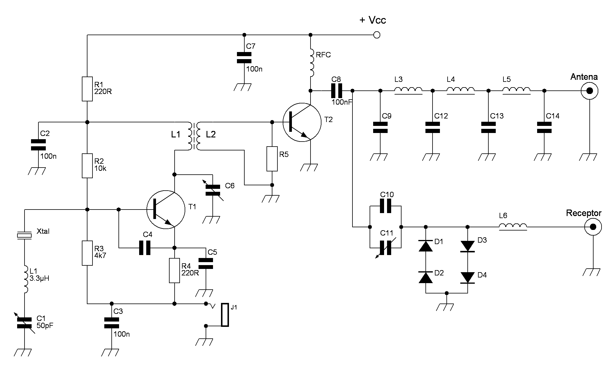

What about this guy?
Works in 3.5, 7 and 14 MHz bands.
The website is in Spanish, so I omit the link, but I look up details if someone is interested.
