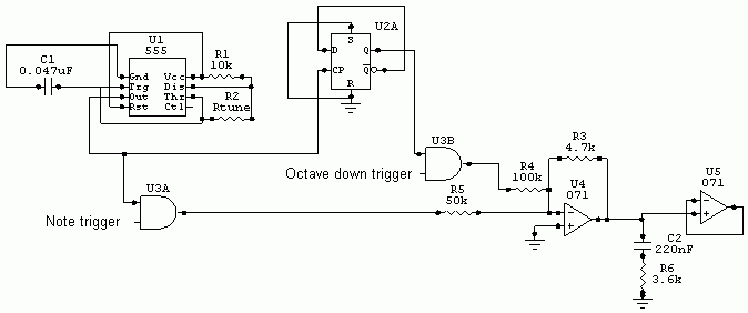

Ok, well I drew up this quickly. 24 notes (2 full octaves) is easy to achieve, though I can see that a major scale may better (less chance of massive discordance!). You could do a 16 note, 2 octave major scale I guess.
You'll see a 555 oscillator, tune its frequency by varying Rtune (no lower than 1k though). To trigger it, supply a logic high input to "note trigger" on the AND gate. Its output is also shown to go through a divide by 2, formed by a D-type flip-flop. To trigger this octave down note, supply logic high to "octave down trigger". The logic outputs will come from the laser triggers once you design a suitable circuit for them.
I have shown these 2 outputs going to a summing amp. You'll have to work out correct resistor values. All the outputs (8, 16, whatever) will go into this summing amp. Notice the high octave has half the resistance, so its level will be twice as high. This is so hopefully you can use a single output filter without the level dropping on higher notes :) . The basic filter is set around 2khz, you'll probably want a better/steeper one. A high pass filter is needed too, to prevent DC at the output.

Wow, thanks everyone. That diagram is great Dr. EM. Thanks for taking the time on that. I must admit my vocabulary is really limited. I've only built a few circuits in class (4-6 total). So I still need to do some reading on the flip/flop, the AND logic gate and also the summing amp. Unfortunately I don't have any of those parts in my kit so I can't test things out yet.
I do think I understand most of the diagram. If anyone can answer though, I'm still unsure about how notes (both octaves are triggered). How would the instrument know I want a note or play it's octave?
For example, I will have a laser pointer probably pointing at a photoresistor/phototransistor and that variable resistor will act as an on/off switch when a certain threshold is reached. I'm just not sure where (on this diagram) the on switch will go to since it looks like there are two triggers? I know if I only had a 555 oscillator that the power would go to the Vcc on the 555, but not sure on this one.

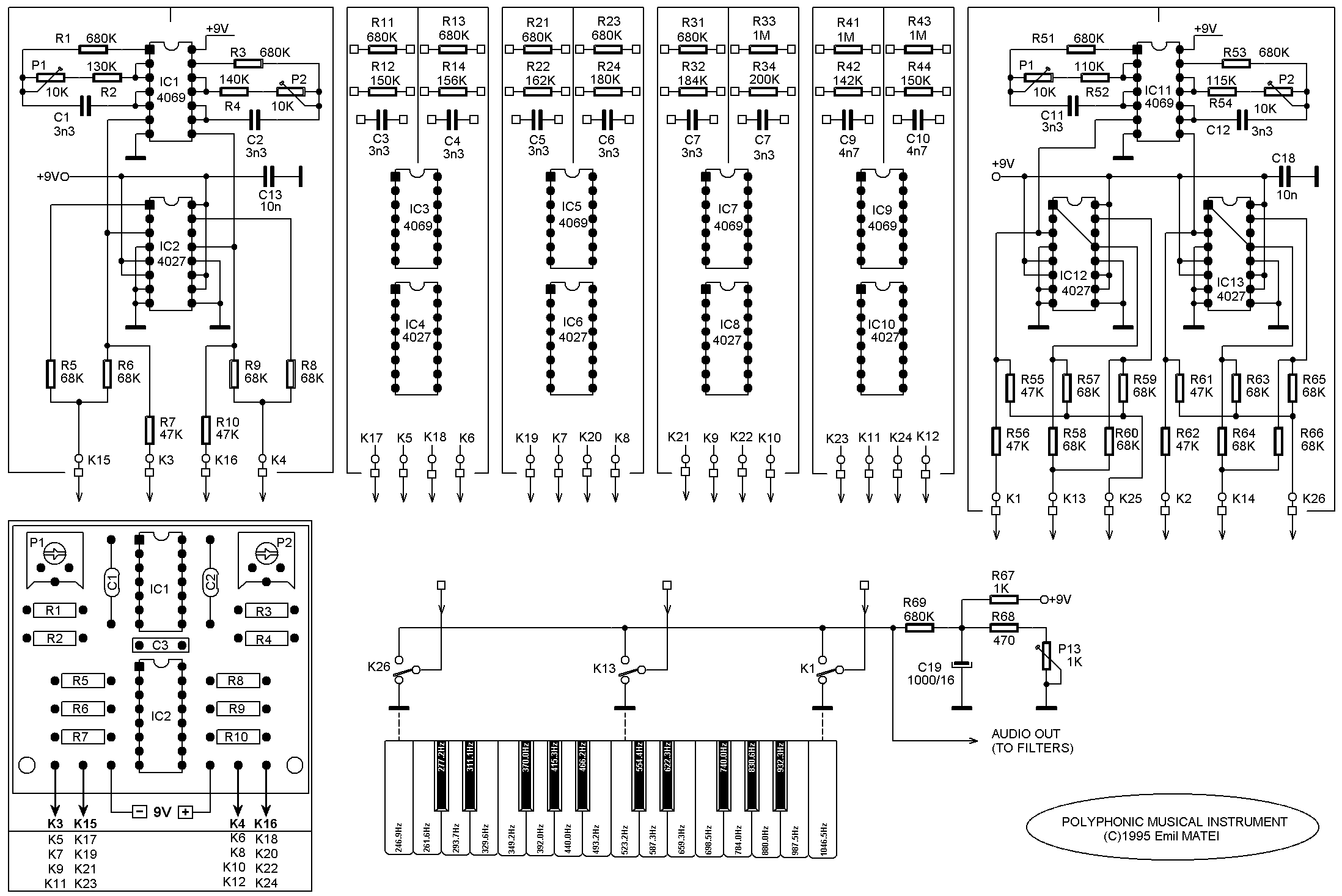

I made a polyphonic instrument having 12 oscillators for top octave,
flipflops for the octave below, and adding higher notes for
harmonics (like Nigel Goodwin refered). The instrument is easy to made,
having identically stages (attachement-poliphonic.png)

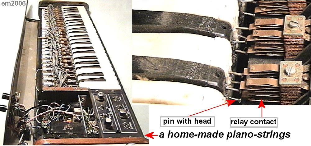

Thats cool, what did you use for the actual keys? I tried making a keyboard for my synth and it was terrible with the tactile switches :( . It would be nice to have LFO controlled modulation of the primary oscillator to get a vibrato effect when desired.
Wow. I'll have to study that diagram too em2006. Too be honest I don't know if I will be able to pull it off. Although it may be easy, my knowledge is really limited like I said. So i'll study that diagram and see if it looks achievable for me.
Based on the diagram it looks like I would need (6) IC 4069 and (7) 4027.
If you don't mind, I have a couple questions. Does the P1, P2, etc. mean potentiometer? It looks like there are 26 notes, is there an easy way to cut that down to 8 or 12? Obviously, 26 lasers would be too much for me. Sorry if this is a dumb question, but are the four top middle diagrams wired like the top left but using the resistor values mentioned? I'm assuming the bottom left diagram is some kind of key? And lastly, can the "audio filter" output go to a speaker instead since I don't know much about filters or wheere would a speaker be hooked up?

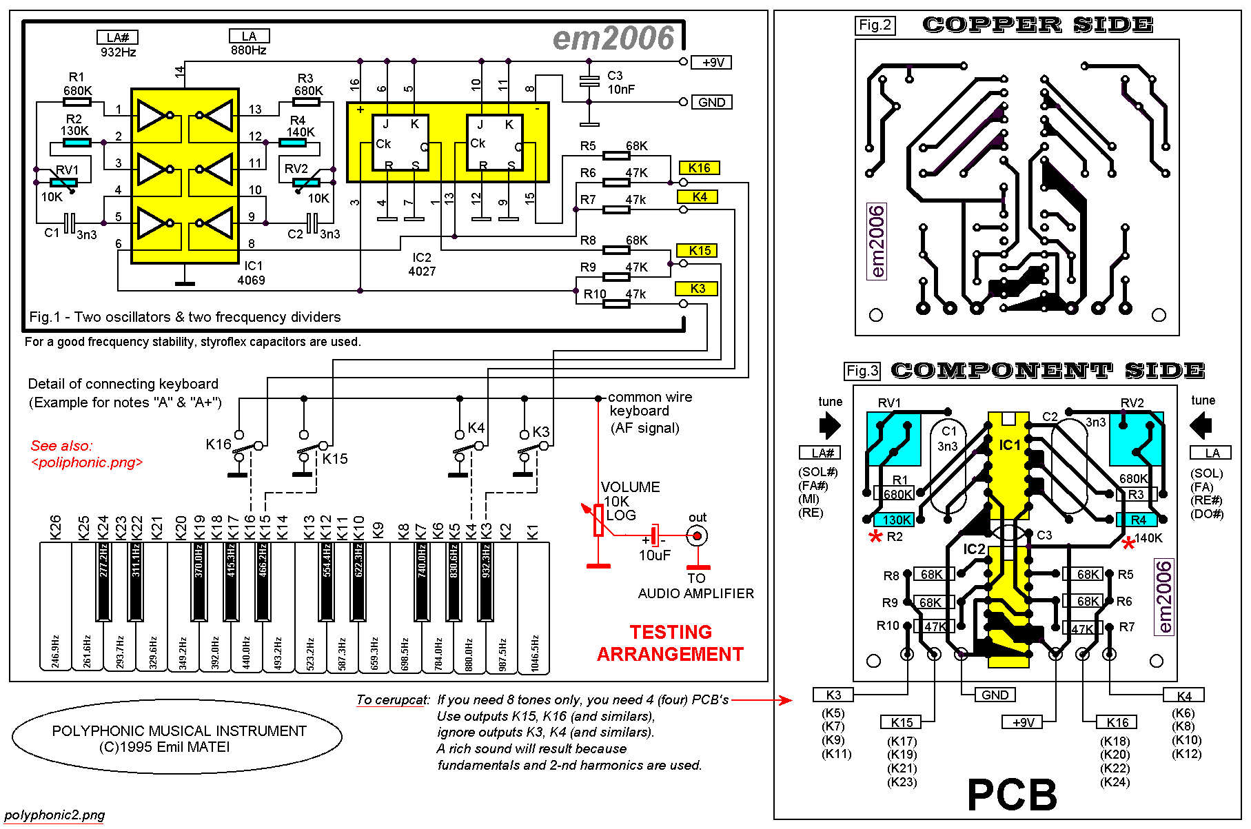

I hope, details and schematic diagrams from attached file (polyphonic2.png),
will help you to understand my project.
Referring to anterior schematic diagram (poliphonic.png), you understood correctly, the four top middle diagrams are wired like the top left (identically),
but using the resistor values mentioned (for tuning).
P1 and P2 are adjustable resistors and they are used for instrument tuning.
The resistors seried-connected with P1 and P2 are Very important too and serve the same scope. Please read again, what Dr.EM wrote in one of his posts: "For tuning, its probably best to tune it roughtly with a potentiometer, measure its resistance, then place a resistor a little under that value in the circuit with a small trimmer in series for fine tuning/adjustments",or respect the values mentioned by me and use 10Kohms trimmmpots(It is better to use the method described by Dr.EM).
You cannot hook a speaker directly to the output of the mentioned schematic diagram, you need to use a small audio amplifier; see the new attached schematic, which is a suggested testing arrangement.
Don't worry about the number of components, you can make only one PCB from the new schematic and test it. If everything is ok and you like the produced sounds, then you can make identical PCBs for as much tones as you need or wish.
In this project, all the sound generators are working permanently but only desired tones go to the outputs, depending on the pressed keys.
The laser commutation of signals represents the second stage of the project, and we will discuss it after you finnish first parts wich consists in the tone generating module and tuning of the instrument.

Excuse me, I omitted an answer to your questions:
On the schematic diagram POLIPHONIC.PNG (1-st schematic),
the bottom left diagram represents LAYOUT of typical PCB 1 to 5.
It is detalied in my previous post.
The 6-th PCB (schematic top right) have a different layout.
Tell me If you need it, I'll send you in the next post.
I used old relay contacts (scrap), actioned by pins fastened into the back of the keys (pushed with a hot letcon) - see attached image.
I know the LFO would be desired, but because the interferences between oscilators, caused by the distribution circuit of the LFO signal to modulated generators (CMOS gates have high impedance), i was forced to use another solution and i used tremolo effect instead. I applied this effect by amplitude modulation of the audio signal from the instrument output (6-12Hz).
