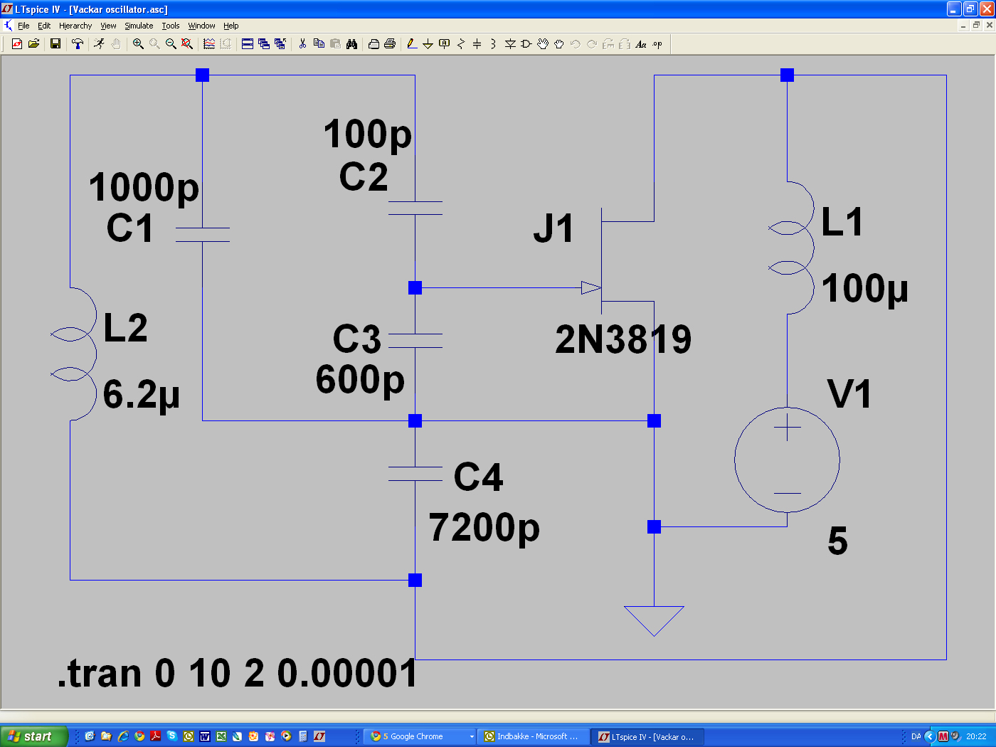

Hello all,
and thanks for your comments and suggestions. Seems that my understanding of what an SMPS includes is not complete ....
I've done a bit of research during the day and the qualities I'm looking for appear to be found in a "Vackar oscillator", where the coil in the oscillator is part of a transformer that generates the higher voltages. It generates a very stable sinus, when simulated.
I've attached an image of an example Vackar oscillator (with coil but not as part of a transformer). I understand that it's a very stable type of oscillator.
Unfortunately, the oscillating frequency of this circuit is about 2 MHz (when simulated) and I would like it to be somewhat lower - in the area of 160 kHz. Any of you know how to calculate this using the circuit I've attached? Or maybe you have a suggestion for an equally good alternative?
