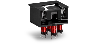

I found a company in Poland making these, unfortunately I have don't have much knowledge of electromagnets, and they are quite expensive!!

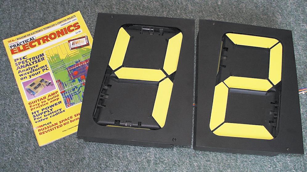

Here are some electro-mechanical digits but the maximum size is 9".

Many years ago, I designed a large digit display sign which used electromechanical digits for a company where I was employed. We made two versions, one had 6-inch displays and the other had 12-inch displays. The display modules were made by Staver and were "Signalex" brand displays. The original Signalex product line ranged from 1.5-inch to 24-inch displays.
Apparently, when the owners of the Staver Co. decided to retire, they sold the brand to another company who in turn sold it to someone else. The company which now owns the Signalex brand is called "Scoretronics" (Link here), but they have discontinued all but the 2-inch and 4-inch size displays. You can still find some of the old, larger displays on eBay occasionally, but they are usually quite expensive.

I had a look at the scoretronics website, those look perfect. Sent them an email requesting priceing on 12" digits. Problem is that I am in Cape Town, South Africa. So converting it into SA-Rands and including shipping costs I am pretty sure it won't be affordable.
They use a dual winding coil requiring a 50ms pulse of 80mA for each segment. I found one requiring a 50ms pulse of 360mA. which is quite a lot of current for one single segment. I can work around that by only switching a single segment at a time, the only problem is that the solenoid only gives me a 4mm stroke.
How do I turn a 4mm stroke into a visible/non-visible segment??

Put the 4mm near the pivot point, or use a lever

It looks like each segment is on a hinge made from a rod/tube with a recoil spring holding it 'off', and theres a cable going through the backplane to the actuator, the actuator could be a bellcrank connected to a solenoid to increase the movement.
