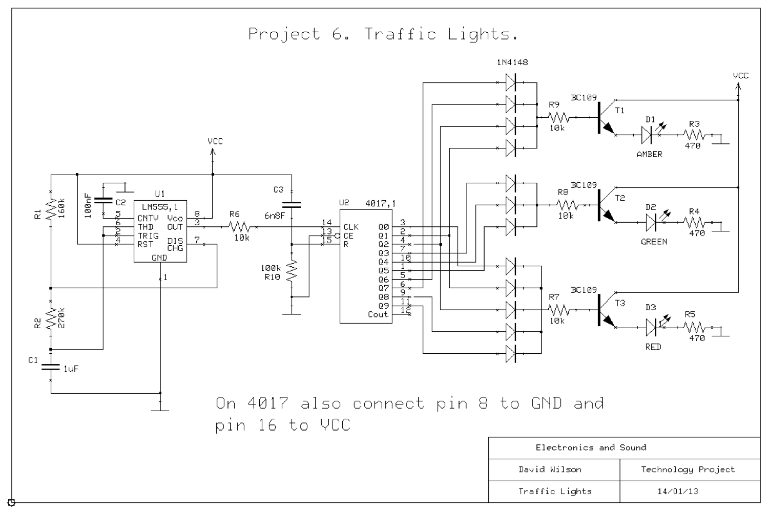

So basically, for my course in university, we had to make a project from a set schematic given to us. we have to transfer that design to a veroboard and make sure it works, but..
the design i made seemed pretty solid but when i applied it to the veroboard, all of my led's light up at a constant, which it, shouldn't.. it should be on a traffic light sequence, so i want to post schematic, along with my veroboard design to see if anyone has any opinions or help they can offer?
This is the schematic..

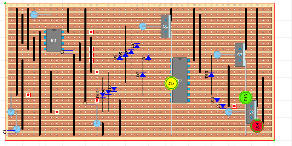

this is my veroboard design..
(note: the red dots represent breaks between the copper tracks.)
(note 2: R3, R4, R5 are connected on the wire with the led's, so that's why they're missing from the verboard design)
Think my best guess is my solder work, it might be connecting to something that it should.

Pin 7 of the 555 chip seems to be missing a link to R1, R2 on veroboard.
Presumably there are many red dots not shown on your diagram?
Aren't those vertical wires shorting all your diodes together? :eek:
Why use so many wires? That circuit could be built with a fraction of the jumper wires you used.
(edit) Yep, i checked your schematic, the diode matrixing should be done BETWEEN the IC and the diodes. Your board is all wrong.
R6, R7, R8 and R9 in the schematic are not doing anything and can be replaced by tracks or wires.

You have all the diodes shorted since the tracks are not cut under them. Also you have the left side pins of the ICs shorted to the right side pins since the tracks are not cut under them.
i forgot to mention that the chips have breaks beneath them to prevent short circuiting along with the diode's, and what do you mean by "replaced by tracks or wires?"

The 10K's R6, R7, R8 and R9 serve no purpose and each one could be replaced by a piece of wire.

The diodes should be up and down between tracks, not sideways. Then many of your track cuts and many jumper wires would not be needed.
I always cut a track at a hole using a "Veroboard track cutter tool" or a drill bit.
You have two jumper wires connected to R1 and R2 when the resistors can connect the circuit with no jumper wires.
Mr RB is right about the vertical wires shorting all outputs together.
Your board layout does not match the schematic. Schematic shows 12 diodes, but you have only 10 on the board - and not wired correctly

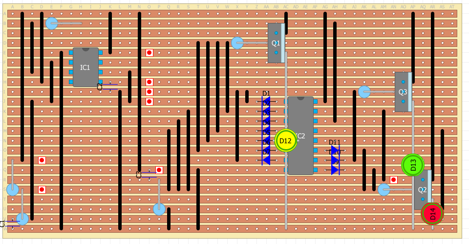

right, i almost gave up on life for the moment, but i just bit the bullet and went for changing the diodes around, i havnt changed everything so it's saved space yet but i will get onto that if it looks good from your point of view.
also i added the missing jumpers on the 555 timer for pin 7, and i do have breaks under the ic's, also r7 r8 r9 are still there but still with the led wire
hope im making progress? :)
the schematic is still on the op

That's certainly looking better, and I don't know any lecturers there - although I did once attend a public lecture/demonstration on holography there.
