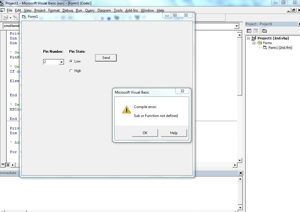

I'm trying serial communication with PIC16f877a but the problem is I'm having problem on my software. I based my software from this site
Visual Basic - Communicating With The Microcontroller
everything is exactly the same. I uploaded an image which shows the error.

hi.
You may have missed out a piece of code.
It should be like this, make sure you have all the 'components' on the form

Thank you mdanh2002 and ericgibbs for the help. I downloaded the whole project instead to have no problem. I got it now working with no problem. I think I just missed something on my own made form. Thank you again ;)
