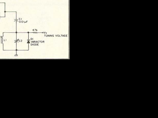

Varicap use - Is this correct?

Isn't a direct path for DC through the inductor?

That's incorrect, you need a DC blocking capacitor between the varicap and the other capacitor.
I agree, incorrect, at the moment you have a DC path from the top of the varicap to ground through the coil, so it will never vary from maximum capacitance, and you may well kill the oscillation as well.
Depending on the circuit, 1n or 10n will be OK. you dont want it too small, otherwise the effective varicap capacitance will be affected by the series capacitance of the blocking capacitor.
Yes your right L1 will short your dc to ground and the 47k will load the osc and possibly stop it, all previously posted.
Its possible that the inductor could be of suffciently high dc resistance not to affect the tuning voltage (saturation might then be problem though), but very unlikely to be high enough not to be affected by the 47k resistor, and even then the oscillator would be uneccesarily loaded

Can you really imagine a coil high enough inductance and thin enough wire to do that :D
Particularly bearing in mind the small capacitance change of a varicap, which means you're usually talking VHF or above.
Where did you find that schematic?
The way it is drawn, it appears to have come from a data sheet or app note.
Nige: yep it'd be like winding a coil with a spiders web, a subminiature spider, one turn around the albert hall with 40swg wouldnt even do it.
