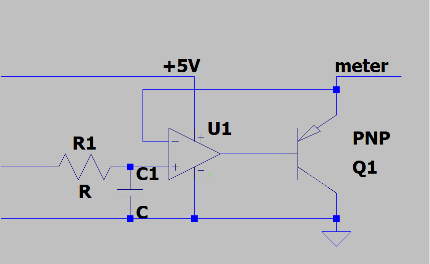

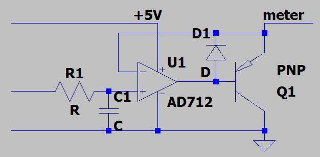

So if you PIC causes a voltage at R1 the opamp will make that voltage at "meter" and force the meter to move. My guess is that forcing the voltage will get you the same results as applying a resistance. (apply 2.4V gets you 75%) Because the meter pulls some power the transistor and amp are needed.
OPAMP needs to be one that works well at 5V supply. Probably R-R input and R-R output. (do not use the AD712)

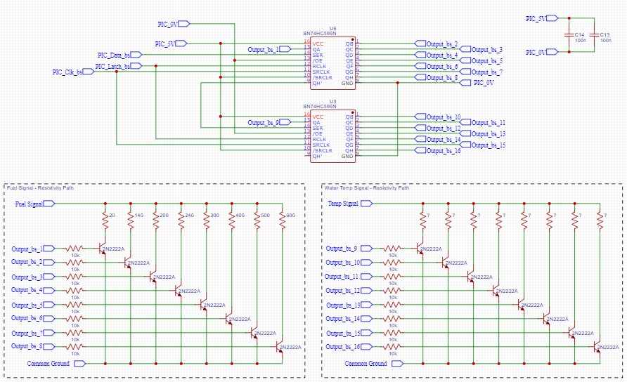

OK, I have an idea, Not sure if this would work but I was looking at this last night, would like to run this idea past you aswell.
I have 3 digital pins I can use on the micro, an I have used this configuration before, not for this purpose, but I think this will work.. please advise?
This is the Bit Shifter cct I'm thinking about with a selection of known resistor values. I can select the resistive path by the bit shifter.
I have also attached the 'make-up' of outputs to drive high to select certain conditions. Altgough I missing a few, I have got the major values, and I think if I mess around alittle more I could get the values I need.
Please advise?

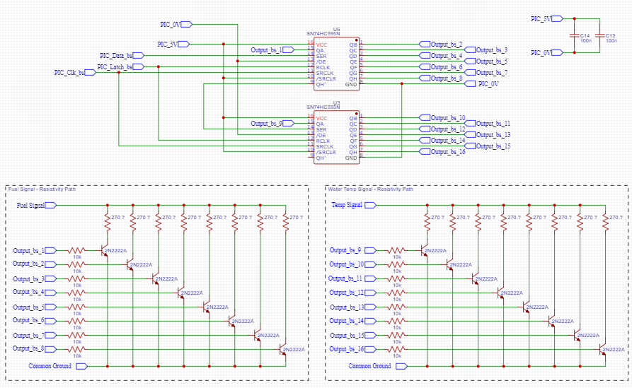

You would get better resolution using a binary- or logarithmic-value resistor set; eg. each resistor something like 1.5 or 2x (2/3 or half) the value of the ones either side of it. Also add one another step higher than the highest switched one, permanently connected.
Switching combinations of those in then give you a wide range of fine changes, rather than just a few divisions of 270 Ohms.
Using eight outputs and eight scaled resistors plus the permanent one give 256 unique values.
eg. 10, 22, 39, 82, 150, 270, 470, 1K + 1k8 permanent should give a decent range, if not absolutely linear.
edit - ps. Looking at your circuit again; if you need more than eight extra output bits, just feed the next shift register input from the serial output of the preceding one (pin 9 for the 595), and parallel the clock & latch pins.
Then send 16 (or 24 or however many bits) before sensing the latch pulse to transfer everything to the outputs.

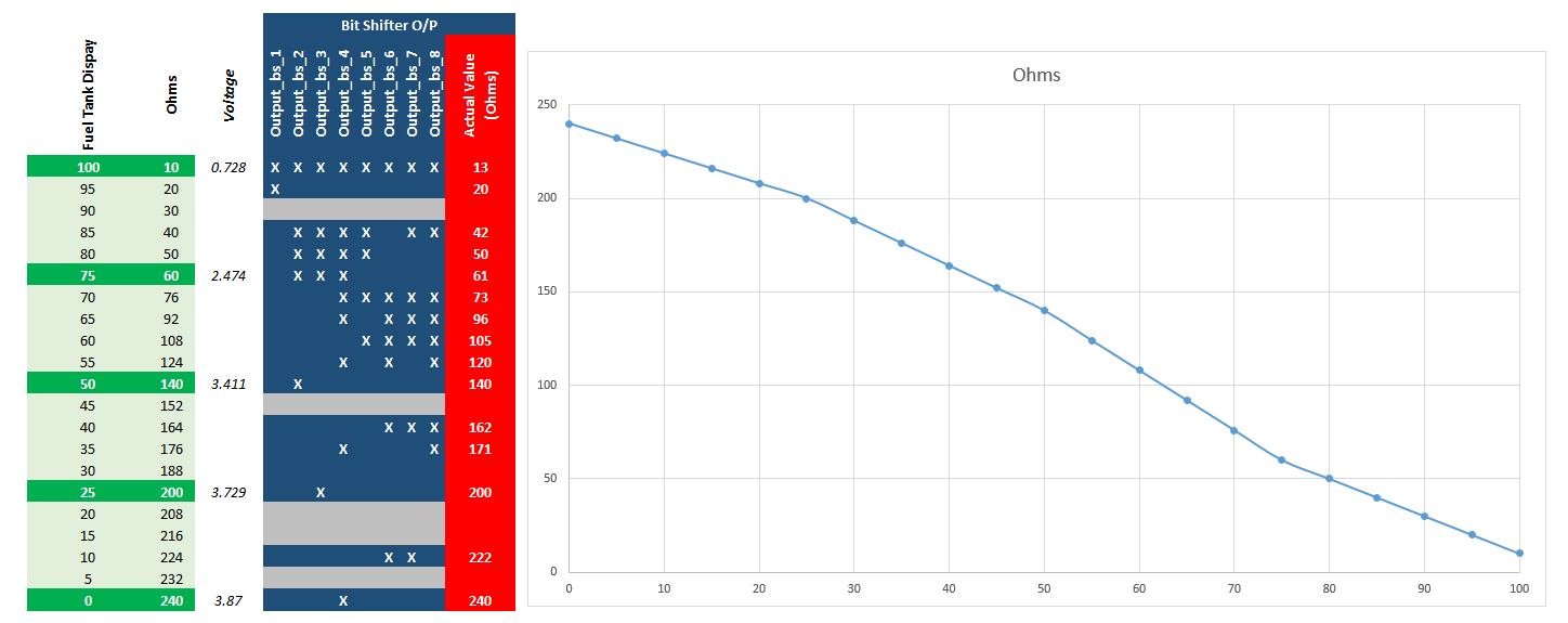

Sorry, I forgot to transfer the values, this is one of the solutons, I have a really helpful gentlemen thats offered another solution on the other forum with alot lett footprint. But this is something I understood. See new Attachment.

I estimate that the sensor unit provides current to the sense resistor from a 4.76112 volt source via a 55.4 ohm resistor. This is calculated from the readings in post #5 I calculated this using the 0% and 100% values in post #5 From this we could do a calculation in the PIC to convert percentage values to a resistance value and use that to select a combination of 8 binary related resistors in parallel. The resistors could selected using mosfets. An alternative would be to control the drive to a mosfet (Behaving as "the resistor") to give the calculated voltage across it. There is some sample code to do the maths in assembler on the Microchip website. (I have used those routines to do the calculates needed to read the output from a BMP280 sensor using a PIC12F1840.)
