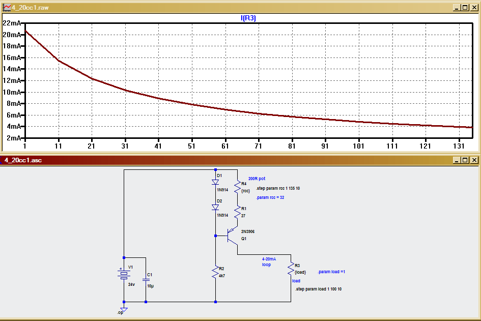

This is a very basic circuit that will provide 4 to 20mA, look at the image.
It will into a 0 to 1000R load.

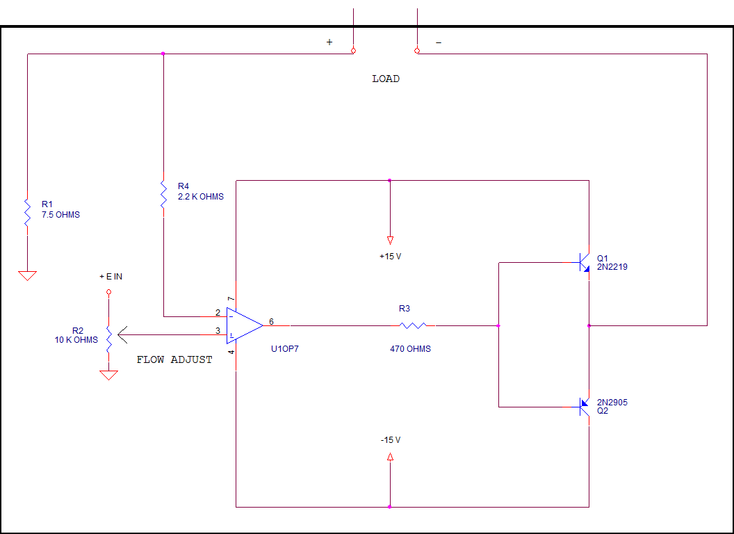

The attached is a 4 - 20 mA source I used years ago. I believe for simple 4 - 20 mA operation the 2N2905 can be eliminated. I used an OP07 but I also think a 741 would work. The 7.5 Ohm resistor should be 1 watt I think. It has been awhile. :) It was designed to operate a current to perssure system for a valve as a manual backuop and it has been out there working for about 12 years. Maybe one of the guys could do a quick simulation for you and verify it.
<Edit> Eric beat me with an even simpler and better circuit. :) </EDIT>
Ron

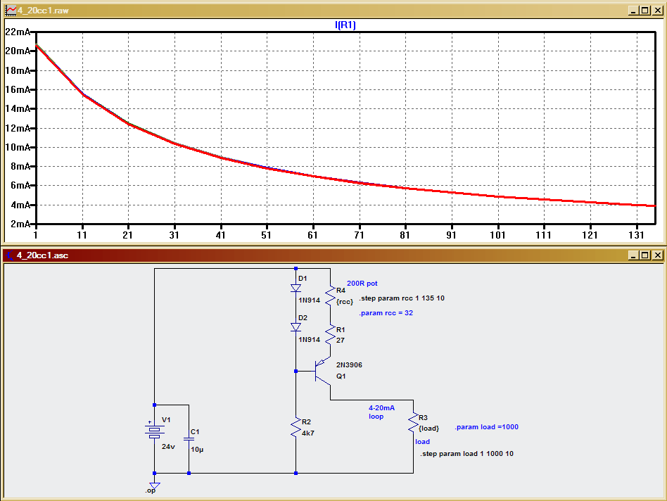

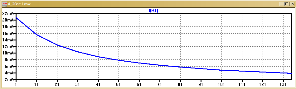

This simulation image is with a load from 1R to 1000R.
Remember it is very basic, you can connect a low impedance current meter in series with the load in order to monitor the current.

Hi Eric,
looks like a great circuit i am going to try it! Question though is R1 a 27ohm resistor and R4 a 200 ohm pot? My typical analog board load is 250 ohms for R3
Your response would be greatly appreciated.
Mike

hi Mike,
The R1 is 27R and the R4 is a 200R variable resistor. Varying R4 will set the constant current value, it will work OK for a 250R load resistor R3.
I split the 27R and 200R , so that the user could not accidentally turn a 250R pot to zero.!
Eric
