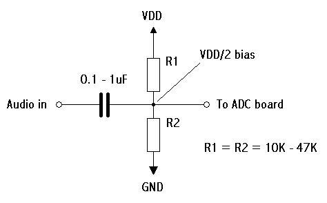

Problem:
ADC - the schem for the board does indeed have an input buffer (with diodes for over voltage protection/clipping) which then goes to a 2-pole low pass filter. Very nice...however....if you look at signal route...theres no caps in series with it. Therefore...the input is unipolar. The ADC does not take a bipolar input (check datasheet page 5 'analogue input characteristics ..0-VDD)...and even if it does...the analogue front end doesn't have the facility to take negative voltage.
Solution:
A small biasing circuit should be added between the audio in form your laptop and the input to the ADC 'module'. Preferably with an opamp, but just for tseting you could use a voltage divider with say 47k resistors, and a 100nF cap. - as I said, not 'clean' but it would at least provide a DC-offest.
The DAC part, with amplifier/RCA connector seems absolutely fine for your purposes. I might have missed something, but it all looks good.

The capacitor is just the sample and hold one, NOT a DC blocking capacitor, and I'm not very sure what the opamp preamps are doing?, but they look to be entirely DC coupled?. If whatever you're connecting to the input doesn't have an AC coupled output, it's going to seriously affect the operation of the circuit, and most probably cause massive distortion.

It's not short circuit protection, it's to clamp any inputs above and below the supply rails (just as a PIC input pin does) - but it's DC coupled, so any DC coupled input to it will short the input to chassis, destroying correct operation of the opamps. Check the voltage on the A2D input pin (output of filter), ensure it's half of the supply voltage (although I fail to see where the bias comes from?), and doesn't change when you connect the input.

Looking at it, I'm sure its fine for audio. I suspect the reason they didn't AC couple the inputs was to give it more flexability, so it could work with DC coupled devices. That is....it can measure an absolute voltage for industrial control applications. Once AC coupled it can only be used for AC waveforms...where-as DC coupled allows the user to use both (with an extra addon).
The input buffer (voltage follower) and low pass filter look fine to me. Of course 500kHz IS too high for an anti-aliasing filter for audio, but I wouldn't worry too much..I doubt the audio out of your laptop has much in the way of >30kHz components, so I wouldn't have thought it would hinder sound quality that much. (of course, its not perfect, but you *should* hear a voice quite clearly).
So as far as the whole ADC board goes...it IS fine for audio, just not specifically designed for it.
Even if your ADC has a VDD/2 bias on its input (I doubt it) the opamps before it don't. So the system you currently have is only sampling the top-half of an AC waveform. Giving you massive distortion (as nigel pointed out) plus...only 6-bits effective resolution.
If you have the facility to knock something up, here's a quick little circuit I think you should try. If this doesn't make a difference then the problem is else-where, and my posts have been in vain
Of course...there's one thing I forgot to mention. Another great little test would be to use a variable DC supply on the input of the ADC module...keep the rest of your setup the same, and put a Voltmeter on the output of the DAC module. (forget about the amplifier for now), Vary the DC input and measure the ouput of the DAC< they should be the same. That would inidicate that both are DC coupled, and you would require the little circuit below.
Good luck,
Blueteeth
thanks for the tips blueteeth, i will try out your advice. Wont be able to get my hands on some components etc until next week so it will wait until then. I do have a volt meter at hand now so can check if its biased at vdd/2.
