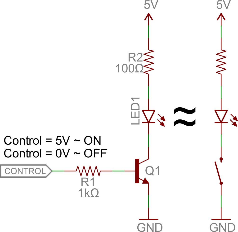

I am trying to desing and build an automated model railroad led signal control system using transistors.
Each signal stand has 3 LEDs red, yellow , green.
The three LEDs in each signal stand are wired in parallel to the anode with a common resistor.
This wiring is to accommodate existing model railroad signal controls (mostly manual) which ground the incandescent bulbs in the signal stand, long before LEDs existed.
I have read a number of articles about turning transistors on and off but they do not explain or show circuit diagrams where the led is powered and turned on when one leg of the transistor is grounded and off when the leg is open.
I may be missing something or not understanding the explanation.
My expeirance with electronics is as an electro mechanical diagnostic and repair technican. There is much more to the control system I want to design but I need a transistor circuit diagram controlling the ground side of the led to start with.
Any help will be greatly appicatated.

A simple common-emitter switch will work to ground the LED. Emitter to ground collector to the LED + resistor, base via a resistor to the control signal (high = ON).
Example from the Sparkfun site:
If your control signal in any case "floats", nether grounds or supplies turn on V
to transistor, you should use a 19K R from base to ground as well That absorbs
leakage and noise pickup (potentially) if switch source disconnects from driving R1,
Regards, Dana.

He asked for the transistor equivalent of a switch to ground; that is all the example is for, an illustration of that equivalence - the LED and resistor in it are placeholders to show the signal assembly, not parts of the actual end circuit.
As Dandak notes, the transistor should also have a base to emitter resistor, eg. 10K, if the "control" signal could be floating rather than actively held low when off. That's just a convenient graphic I found for the general principle.

Bruce: Any NPN transistor can drive your estimated 10~20 mA 12V R/Y/G lamp low side with a 10k base resistor from any CMOS logic.
