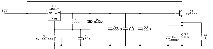

I am using LM317 and taking about 1 Ampere from it's output now i want to increase output current about 4 Ampere.
In the circuit below,
i have attached a transistor 2N3055 for increasing current.
Will this work?? or any suggestion.

Keep in mind that if you plan on using the supply at 1.5 volts and 4 amps, that you'll need to dissapate quite a bit of power - most in the 2N3055 but some in the LM317.
Is the 30 volt input well filtered?
Hi Ayne,
Your circuit will have poor voltage regulation because the output voltage is not fed back to the LM317 for error correction.
Also, the LM317 regulates very well. then the very high value of C1 in your circuit isn't needed.
You should look at the datasheet for the LM317. It shows that your R2 should be a max of 120 ohms and the extra-priced LM117 should be 240 ohms max, or some of them will have their output voltage rise without a load.
The datasheet also shows a High Current Adjustable Regulator circuit but it uses National's expensive unusual transistors.
The datasheet for the 78xx fixed voltage regulator shows a similar but simple circuit for a High Current Regulator using a booster transistor. You could connect a booster transistor to the LM317 the same way. Then you will have high current with excellent voltage regulation.

Nope. It has a plastic package and is too small for high power. A big metal-cased power transistor is needed to increase the power of an LM317.
The LM1084 has a max dissipation rating of 37W on a huge perfect heatsink but you will be lucky if it doesn't overheat (shutdown) if it dissipates 27W. With a 30V input and a 5V output then its max temperature is reached with a load current of only 1.08A.

You can use the 1st circuit you posted. Move the 1000uF capacitor to the 30VDC input if there isn't enough capacitance there.
The circuit will have lousy voltage regulation but lead-acid batteries don't care. The 2N3055 needs a huge heatsink and maybe a fan because 80W is a lot of heat for it.

The LM317 regulates very well if its R2 in your circuit is 120 ohms or less and its input voltage is 2.5V or more higher than its output. But the base-emitter voltage of the 2N3055 transistor will increase when the load current increases so the output voltage will drop about 0.4V up to 0.9V when a 4A load is connected.
The circuits that use a booster transistor have the LM317 regulating the output voltage much better.

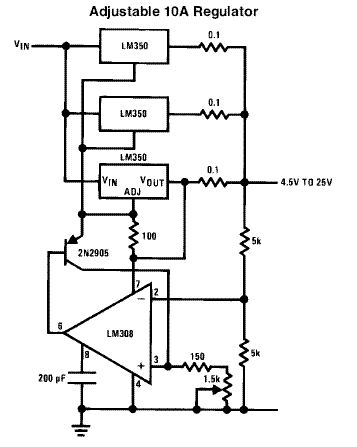

I found this circuit on LM350 datasheet.
What r ur views about this circuit??
Can i use any opamp???
