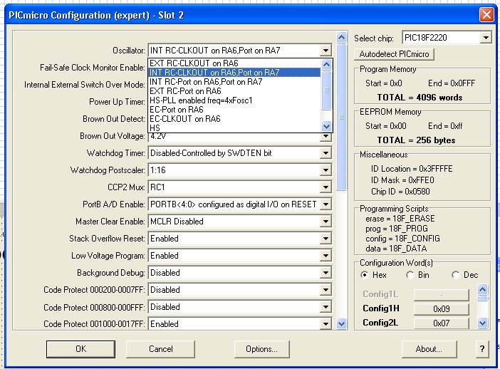

I am having troubles with setting the internal oscillator for the 18f2220 to it's maximum value of 8Mhz. When I run the program, it runs very slowly. I am using flowcode which has a config screen. It has no option for setting the speed.
Is there a certian config word I can use to set this value?
Thanks in advance...
Cameron
It also depends on what languish your using to but is not a configuration word
You should added it before you set up your ports
OSCCON = 0x72
TRISA = 0xFF ///don't use this it just here for clarity
