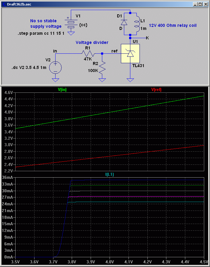

Or you can use a chip like a TL431 which is like a comparator with its own built-in stable voltage reference. No need to regulate the supply voltage.
For example, here is a circuit that picks up a sensitive relay as the voltage V(ref) crosses 2.49V quite independent of the supply voltage as the supply voltage goes from 11V to 15V. The current through the relay coil (and hence the relay pull-in current) is independent of the supply voltage.
Note that the actual trip point of V(in) can be ratiometrically adjusted from 2.49V on up just by picking two resistor values (R1 and R2).
Circuit is much simpler (and likely more stable) than using an opamp or comparitor to drive a relay...
