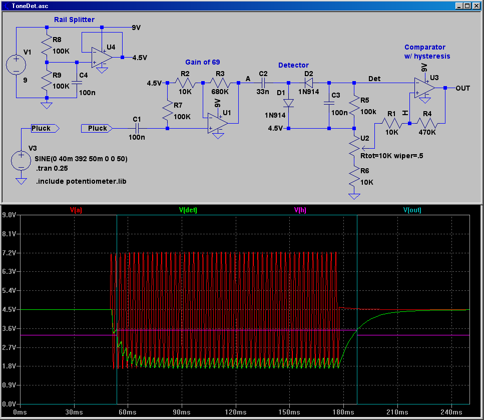

Can anyone please tell me how I can use an analogue signal from a piezoelectric sensor (placed under the bridge of a stringed instrument) to trigger a comparator when the signal level goes above a limit? Is there some way of converting the audio signal from the piezo sensor to dc for use in the comparator?
I’m sure that there’s a probably fairly simple answer but I can’t figure it out. Help required! Thanks.

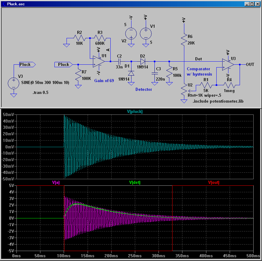

Your piezoelectric transducer will produce an AC signal when it picks up the sound (vibration) The amplitude will be a function of the "bang" and only last for the duration of the sound. The output of the comparator will be a pulse only for the duration of the bang. Since the piezoelectric transducer output will be a low level signal you may want to amplify it a little. The pulse out will be a high to low or low to high depending on how you configure the comparator.

If you dont rectify it, you will get a series of pulses out of the comparator while the string is vibrating at an amplitude above the threshold of the comparator.
I'm guessing you will want an amplifier (gain 10 to 100), followed by a two-diode-detector going into the comparator. That way, the output of the comparator will be high/low (your choice) while the string is vibrating.
Something like this:
Since the vibration has an exponential decay, where do you want the comparator to shut off?

I have sketched out a couple of graphs to give a clearer image of what I am trying to achieve. The input is an audio signal from a piezoelectric sensor. It is mounted below the bridge of a drone string that is used for the rythmn on a musical instrument. Normally the amplitude and frequency of the signal remain constant with the exception of periodic pulses of increased amplitude that form the rythmn. I want to try to capture these pulses and convert them to a square waveform to eventually trigger an analogue switch.
The frequency of the audio signal will be set at either 392hz or 440hz and so I think that you're probably right Mike, this will be recognised as an ac input by the comparator and it will out series of pulses at the same frequency. Consequently, the input signalwill need to be rectified. It will also need to be amplified as you suggest as the piezoelectric sensor outputs a very low level signal.

The circuit Mike posted will give you pretty much what you are looking for. The red trace in the circuit is the output of the comparator. To have the output swing positive during the duration you would swap the inputs to the comparator chip. That output in turn could be used to drive your analog switch.

As Ron pointed out, the red trace V(out) is the output of the comparator, the decaying signal is the output of the detector, V(det).
Think of the circuit as three independent blocks; the gain stage, the detector, and the Schmit Trigger (comparator with hysteresis). Note that for proper operation of the detector, the amplitude at the output of the gain block V(a) needs to be a minimum of a couple of volts, so adjust the gain of first stage as needed. To invert the output, flip both diodes in the detector so that it puts out a negative voltage, and set up the trip point pot as needed.

Here is another version that operates on a single 9V supply, and inverts the polarity of the output. Note the Attack delay and Release delay. This is about typical for this type of tone detector.

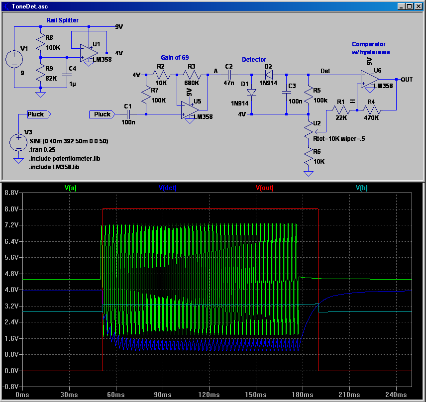

The new circuit design seems fine. I'll try it out on a breadboard and let you know how I get on. The input signal will pulse at a maximum rate of 10hz, so each pulse will have a duration of about 50 milliseconds. Is your graph in milliseconds or microseconds? Either way, the attack delay is negliable and can be ignored. The decay delay is somewhat longer but it shouldn't cause any problems as the squqre wave generated will be used to triggers an analogue switch and this in turn activates the sound for the rythmn. As long as the sound signal turns on at the attack of each pulse and turns off before the arrival of each sequential pulse then the rythmn should work correctly.

The X-axis scale is 0 to 0.25sec or 250ms.
V(h) is what V(det) is being compared to. Note how the hysteresis offsets V(h).

Converted to LM358s (MC4558?). Note that for such a slow detection rate, you do not need to use a true comparator chip. Since the LM358 is not rail-to-rail out, I offset the mid rail down to 4V.

OK Mike, I'll use the op amps you suggest. I can see what you've done to reduce the voltage level. And to answer Pete's question, no, the piezo sensor is just a small piece of piezo film about an inch long:
There's no driver, just a short length of coax that connects it to the circuit above.
I tried the sensor output on the scope. The result isn't quite the same as the clean block pulse on your graphic image; in reality the pulse section starts with a surge and has a slight decay as it progresses. However, the amplitude of the pulse is still far greater than the basic tone signal between the pulses and the comparator should not have any difficulty in recognising the difference between the two states.
