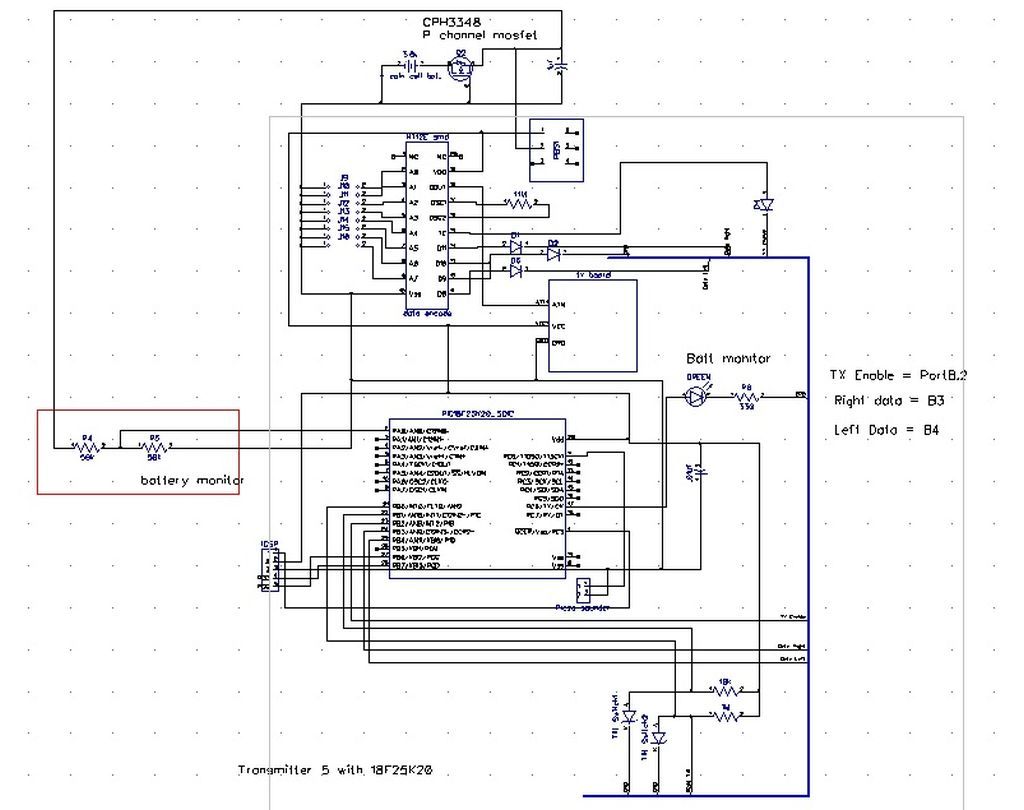

The transmitter circuit draws less than 10ma (estimated) and powered by two coin cell batteries (transmitter needs 2.4v to operate but one battery is only 3v(not much head room.
Perhaps I should post a schematic. Was going with just a diode.
Overkill?
using the P mosfet to prevent reverse polarity and two coin cell batteries as the transmitter operates on 2.4v min.
Schematic shows a battery monitor which I might not include.

I like to stay away from the ICSP pins if at all possible. When I first got started with micro controllers it was suggested not to use as it COULD cause issues.
Anyway I got to thinking that if I use the same chip in both the Transmitter and receiver I would offset the cost by buying in larger quantities than buying two different chips.
Now I need to decide if I need to go to the trouble of using two coin cell batteries = 6v or one = 3v. Using the one cell I eliminate having to use a voltage regulator. BUT the transmitter operates from 2.4 to 12v. At present the transmitter circuit draws 15ma at 3v upon transmission BUT I have two LEDs for testing so in actuality it probably draws less than 10ma at transmission. So a 2032 coin cell has 225mah. Wonder if there is a way to compute how long the battery will stay above 2.4v.
Doing research at present.
You sure don't care how long the battery last less stuff it last longer
I have the minimum components as per data sheets etc.
I inserted the P mosfet just so a reverse polarity won't occur in the event the battery is inserted backwards. I feel I probally should go with two batteries but really don't want to. The transmitter circuit, in standby mode draws 6ma.
The encoder chip data sheet recommends the diodes (I only have two instead of 4)
The tilt switches are needed. I could go a higher pullup resistor for less current draw.
Can't see anything I can delete but open for suggestions.
The battery It will last a week but you could make it last maybe 4 weeks or longer
Well that battery has a 240mAH rating that means you could draw 240mA for one hour if your transmitter used 10mA
240 / 10 means 24 hours till the battery is dead.
DUH your correct. Will remove the temp LED. The 10ma is transmitting which is two seconds at most but need to measure standby without the LED.

I clipped the leds and standby = 4.8ma
transmitting with a delayms of 2000(need to change, used for indication) = 14.9ma
BUT how long will the battery stay above 2.5 for transmitter enable voltage?
Has anyone seen such a calculator for battery degrade life?
still would like more life but then I would have to add a voltage reg unless I can find a battery holder that puts two coin cells in parallel. YEA good luck with that.
The battery is dead at 80% your going to 70% The only way to get this to last is
One put the pic to sleep if a button pressed wake it up and take action you could even let the led come on when you press the button.
Two put a slow crystal on it .
And put it back to sleep LOL
Those remotes that use small battery's don't use any power till you press a button.
