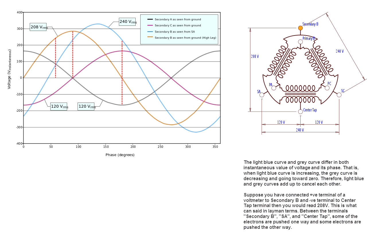

Hi
My friend needs to install a grid-connected PV inverter. The mains are open-delta 3-phase 240V (it might be 208V, I would conform it soon) configuration. Could you please tell me that if it's possible to connect an inverter to an open-delta mains? The electric utility wouldn't have any problem.
I need to find an appropriate inverter. I was able to find that SMA-America manufactures inverters which could be used with open-delta as is **broken link removed**. I wasn't able to find one from **broken link removed**. An inverter from Fronius would be preferred. Thank you.
Regards
PG

Open delta should be 240 volts. I've never seen a 208V open delta. It would require a pair of very strange transformers for 208.
If you can drive two single phase 240 volt inverters from your solar panels, it should be possible to wire them, open delta, to the grid and they should synchronize independently.

1: (Delta 3-phase system)
i: https://en.wikipedia.org/wiki/High-leg_delta
ii: **broken link removed** (shows different form of delta configuration)
iii: https://www.electriciantalk.com/f2/explain-stinger-high-leg-23606/ (high leg, stinger, etc.)
iv: https://control.com/thread/1026198752 (might be good; didn't read carefully)
v: https://www.electro-tech-online.com/attachments/highlegdelta-jpg.92158
vi: https://www.pumpsandsystems.com/topics/pumps/pumps/why-wye-why-delta (good one)

Would it be possible for you to show me a schematic or link me to some source?
I wasn't thinking of any specific product, but if you have two single phase inverters that are designed to be synchronized to the grid, then I can see no reason why you couldn't connect their outputs in open delta fashion, as long as the inverter outputs are isolated from ground. They would essentially be independent of each other, and each one would synchronize to the phase that it is connected to. However, having said that, I would still recommend that you check with the manufacturer.
