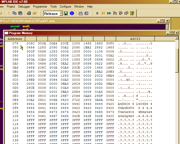

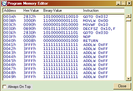

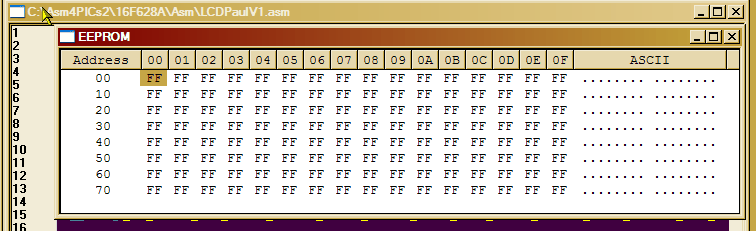

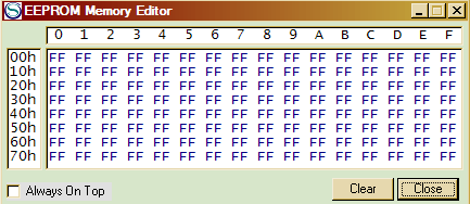

hi Paul,
Do you mean FLASH memory or EEPROM memory.?
EEPROM starts at 0
Look at the program Code to check where it ends in Flash.
EDIT:
Shown in Oshonsoft

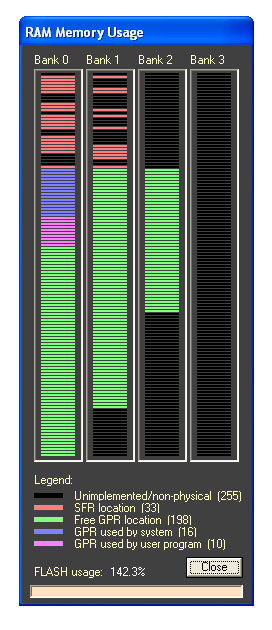

Hi Eric. Sorry I didn't expalin that very well. I have a few questions now.
I have a program written in oshon pic basic. When I compile I get the bar graph thingy which I don't rightly understand if im honest. What does everything mean? Is the green unfilled space. If so why do programs that are too big to fit on the pic not fill upp all the available green area? Secondly how do I see where the program ends in flash?
I want to store some variables in EEPROM so that they are there the next time the program is run. Obviously I want to store this far away from the main program.

hi Paul,
Store variables, that you want to recall at the next power up, in the EEPROM section of the PIC, a 628A has addresses 0x00 to 0x7F for EEPROM.
The FLASH memory is for the program code itself.
The RAM is for volatile memory usage [ not remembered at power off]
