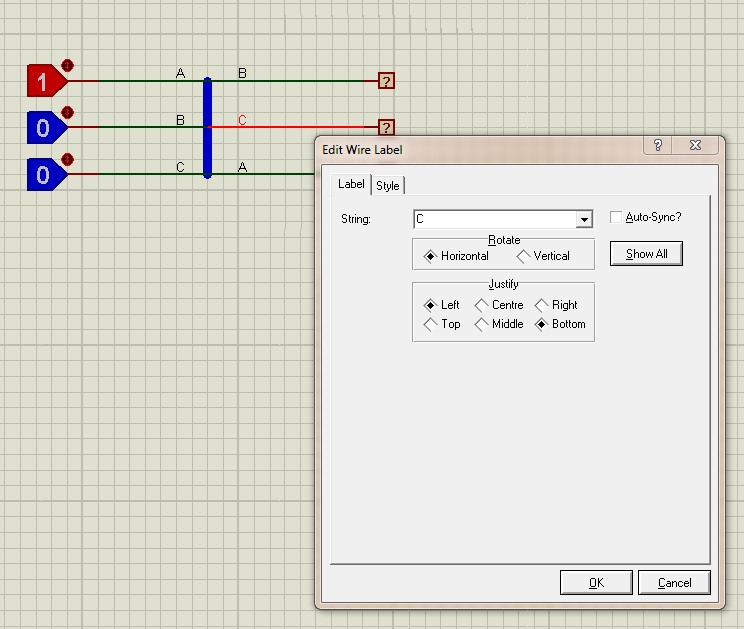

i am trying to work with 8086 in proteus which has AD[0 ..15] lines as a bus. however i need to separate the lines from the bus.
how do i do it?
thanks
When you use the bus ( big thick blue line ) each time you connect to it you right click on the connecting line and edit the LABEL to define its entry and exit... This way you can have many entry and exit points..
