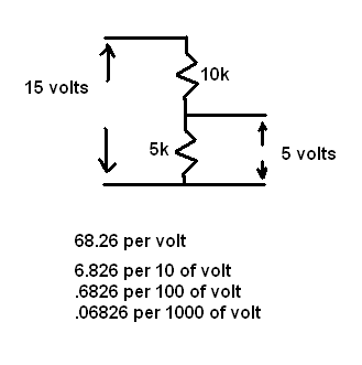

Hey, I am using the 12F675 and AN2 with a couple of resistors to divide the voltage to allow me to check the voltage of a battery, this works great however I would like to know if anyone has the formula or a table/chart of what each voltage point turns into as a digital variable?
I am using a 10k and 20k resistor to divide the voltage on AN2
I just need to know how to figure out what the digital converted value will be. IE 4v = 200 or something ?

The AD reading (assuming 10bit AD) = INT(1023*k*Vbat/Vref),
where:
k is your voltage divider factor, in your case R2/(R1+R2) = 10K/(10K+20K) = 0.3333
Vbat is the battery voltage.
Vref is usually the PIC's Vdd, likely ~5V. You need to measure the actual voltage to at least three significant figures.
INT( ) is the integer function.
1023 comes from the number of bits, 2^10-1
for example, if the battery voltage is 14.00V and the Vref is 4.950V, the AD reading would be 964 decimal (03C4 hex).

Why is it that every one wants to use 1023 that's wrong there are 1024 steps in 10 bit ADC not 1023
Adc values are held in two 8 bit register so there is not a limited like there would be if it was just 10 bits wide
Ok, so the expression for the AD reading (assuming 10bit AD) = FLOOR(1024*k*Vbat/Vref), where FLOOR() is the C function.
I dont understand what you are saying about two eight bit registers? There are still only 1024 unique values, regardless of how the bits are packed into two bytes.
Most every one thinks thinks it is only 10 bits wide so it can only be 1023 but it's 1024 steps in two 8 bit register's.
It 1024/volts =

No, Think of it like this. If Vref=Vdd=5.000V, and we put 5V into the AD in port, then the AD reads 1023. If you put in 3.83V, then the AD puts out (3.83/5.00)*1024 = 784.384, but since the AD must put out an integer, then it has to be truncated down to 784.
The voltage divider puts out 1/3 of what goes in, so to get 3.83V at the AD in, the battery voltage must have been 3*3.83V = 11.49V.
So where does 261 come from????
Another quick one, how do I determine the reference voltage? this is just the supply voltage to the PIC?
Yes, but to do the math accurately, you have to measure it with an accurate DVM, measure it to the nearest mV, or so.
