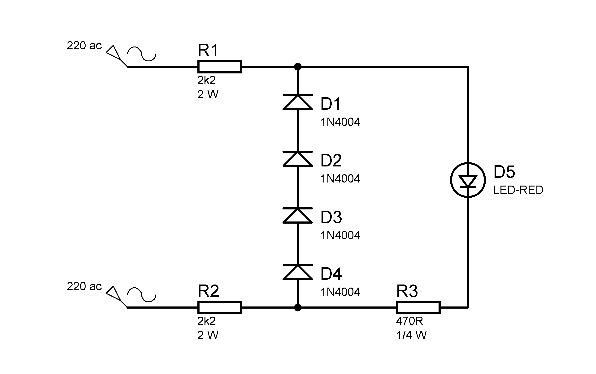

Hi, can anyone suggest a simple circuit which lights up an LED with 220V AC. I am trying to make something without the use of transformers.
Maybe a bridge rectifier and a resistance connected with LED.
What should be the resistance value (is 1M enough) ?
Most LED's don't like being reversed biased by more than a few volts so you will need to add some diodes to protect your LED.

220 v AC rectified will give you about 300v DC
since you didnt put the specs of your led lets assume your led is red..2.4v @ 20ma
this works out that you need a resistor rated at 15k ohm @ 6watts
Thats a big resistor, it will just gets hot and use far more power than the led uses.
Simply put its impractical.
What do you intend using this for as there is more than likely a better way to do this

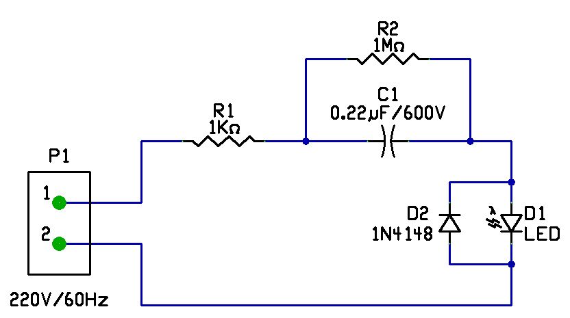

I found a similar thread https://www.electro-tech-online.com/threads/convert-220-ac-to-3-6-vdc-for-lighting-led.36652/ however they are using Capacitors as well which will make circuit bulkier.
Will this circuit work too ? **broken link removed**
It is the only solution that i know. you will have to use a circuit as shown by the above post.
The impendence of the cap is used here instead of a resistor to limit the current.
The benefit is that a cap doesn't heat up, as the current ans voltage are 90deg out of phase.
You can use a simple formula for the impendence of a cap.
Z=1/(2*pi*50*C)
Generally, as it is shown, 180-220 nF is fine for a 5mm red led.
And dont forget to use a diode to prevent high reverse voltages.
A 1n4007 in opposite dir in parallel to the LED will do.
Make sure that the voltage rating of the cap is 400V or so.
But, this type of supply is not recommended if you plan to use it for serious circuits.
Use a limiting cap,a fuse,a full wave bridge rectifier, a zener and a filter electrolytic cap to create a useful power supply without transformer.
Limiting caps with values ranging upto 2.2uf 400v are small enough to be used as a cheaper and smaller alternative to transformers.
But, don't think of using transformerless supply for expensive circuits. They can blow anytime.
I found an even simpler circuit.
The only problem is that the LED is not very bright. Can anyone suggest how to make it a little bright.? I am using standard green LED.

That 1k is not really required.
Use 4007 instead of 4148 and 380nf or near about.
The circuit is halfwave and you will get 25Hz flicker, which is noticeable. 100n caps will only deliver 10mA in full wave or 5mA in your situation, so a few 100n in parallel is required. They need to X2 caps or at least 400v.
You really need a full wave rectifier at the front end for better results.
