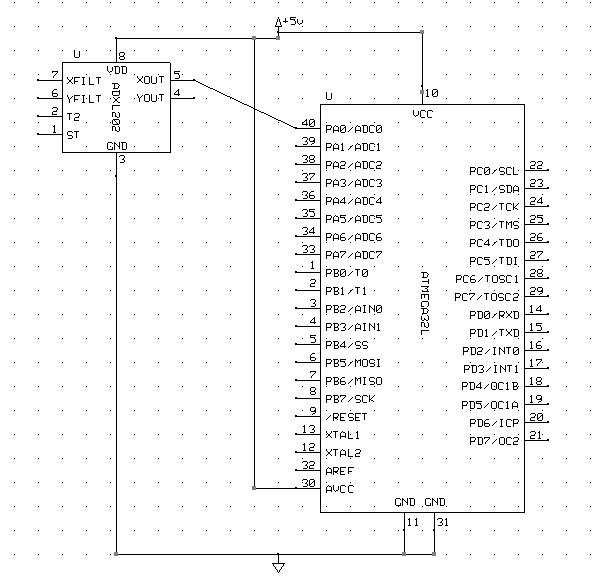

Here is the schematic. I think I included everything that is relevant to the accelorometer circuit.
~Mike

What type of file is that? Its much easier if you post a screen capture - odds are I'm not using the same schematic program.
The file above is from Eagle.
I'll post a screenshot though.
The accelerometer in the schematic is an ADXL202. The one I'm using is the 103 and has only 4 leads...Common, Vcc, X-out, and St, which is for making sure it works. I haven't read on how to use the ST lead.
I have tested the output of the Accelerometer with my digital multimeter and the voltage seems to hold still, but when I send it through the ATMEGA, something screws with the signal.
~Mike
Adding a cap between ground and AVcc is a good idea. Some microcontrollers need a cap from VRef to ground to keep the reference nice and stable - check the ATMEGA datasheet. Other than that its almost certainly a problem with how the ADC is set up in software. There should be tons of AVR code on the net for setting up the ADC - try checking your code against some examples. Atmel probably has some appnotes on setting up the ADC too.

Alright! Thanks for the info bmcculla. I put a .1uF cap between 5V and Gnd as well as a .01uF cap between the Accelorometer output and gnd. I am getting absolutely no variation in angle when the sensor is sitting still.
Thansk again!
