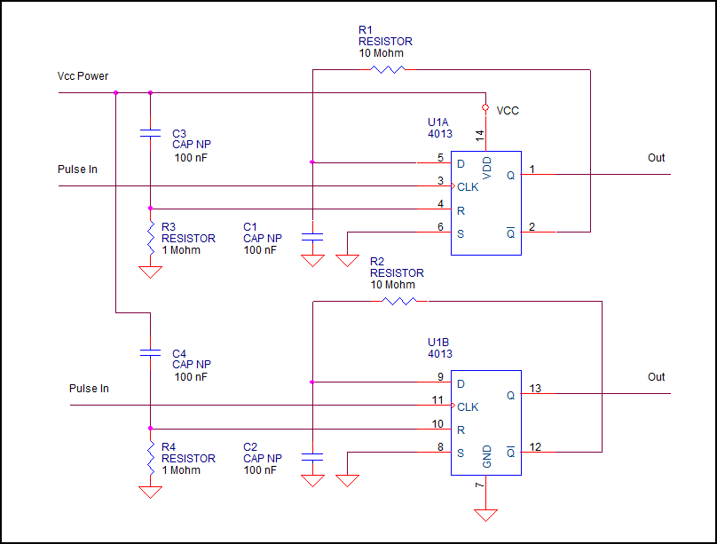

How can i modify it to click and latch a relay when i press the button from any ware in the house. Also if it is somehow possible unlatch the relay when pressed again. Im sure you know what i mean.
I was looking at it, all i think i have to do is create some sort of maybe, flip flip circuit (if i understand what they actually are correctly) so it will take the first signal, and send it to the relay, which will latch somehow. then it waits for a second signal, that it will just cut the power to the relay, or unlatch it.
Also, i thought about using a MOSFET as a switch, as it will conserve battery power that will be taken from energizing a relay coil for however long the circuit is active.
Thanks boiz.
As far as the latching you could likely just use a D flip flop. You will need to take a look at the signal sent to the actual chime device or whatever is used for sound on the doorbell. But yeah, it should be easy enough to do. You will need to come off the F/F and I would drive a small transistor to drive the relay, maybe like a 2N2222 depending on what you want for a relay. It all starts with the actual signal you have that makes the sound.

I measured the DC output from the wires that origonally lead to the speaker, and it puts out 3V steady for 8 seconds, then it goes to 0
So, what kind of flip flop do i need. (i dont know what they are, ill google them later) you said D type, is that one thing? can i google D type flip flop and any will do??
As for the transistor driving the relay, i can do later. i just want to get the actual circuit that tells the relay system what to do working off the chime signal

Attached is an example of using a D flip flop as a latch. However, I like Collin's circuit. His would appear to do it all without any need for signal conditioning.

So i connect the doorbell speaker output to the two leads at the bottom left. The base and emitter of the BC547??
And this will cause the relay to latch with one press, and unlatch with another press?
ohk, so the motor is just a relay add on, cool i understand :)
Lol yea its been off for ages :p
What did you mean "short tone on, long tone off" before
but the doorbell transmitter is pushbutton, i dont think it works off time its pressed for. You press it once and it does its tone, the output wires im using are from the speaker. Thats where there is 3V for 8 seconds, thats from the tone as it plays. if i hold the transmitter down for a long time, it doesnt make a difference it just sends a signal to the receiver, and the circuitry there takes over in playing the tone
