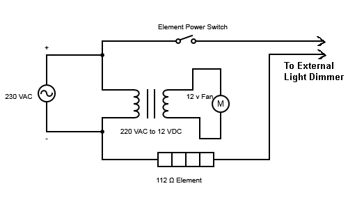

I was wondering if I could use a toggle switch with a diode to halve the voltage flowing to the element. 115 V at 112 Ω is 118 watts.
I'd like to believe this would give me a nice warm air without being too hot.
Here is my proposed diagram

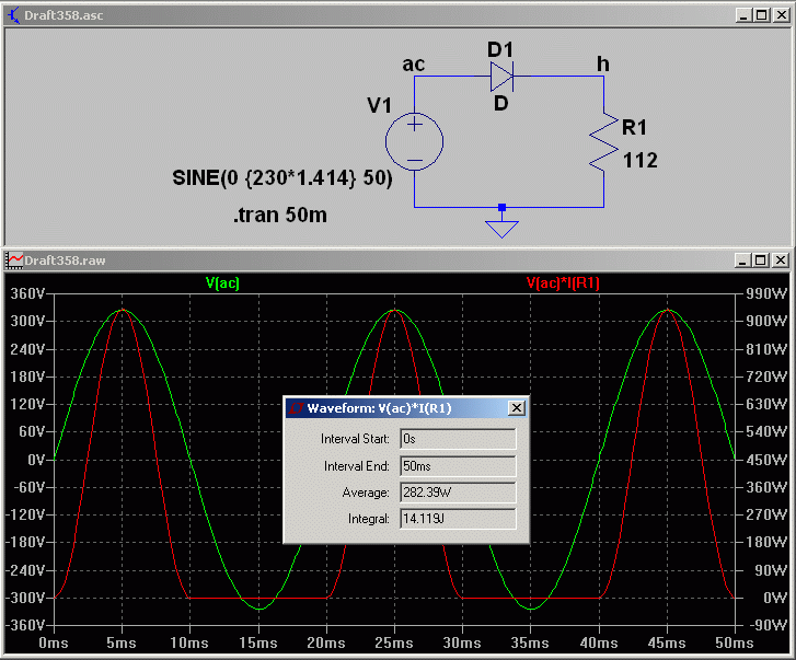

Putting in a suitable rectifier would drop the power in the heater from ~460W to ~230W, which might still be too hot...

Not quite:
That looks like a standard shaded-pole AC motor running straight off the power line. What makes you think that that is a 12 V fan motor? Where is the transformer?
ak
Yes it is a 220 VAC Shaded pole Motor.
So your DIODE or a Light Dimmer Must NOT Connect to the Motor.

Are you SURE your Dehydrator is Rated for 220 VAC? (Not 110 VAC)
If so, than In MY OPINION, The BEST Way would be to Connect a Dimmer Control in either the Black or White Wire going to the Heater Element.
It would than Give you FULL Temperature Control.
The Dimmer can be Mounted in a Separate Box, OUTSIDE of the Unit, so as to Not really Changing it.
Just a Small Hole to bring the Wires through.

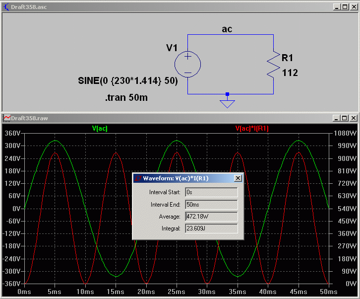

Should'nt the averaging interval be multiple of the 50Hz cycles, 20ms, 40ms, 60ms ... , not 50ms.
Good catch! I repeated the LTSpice runs with an integration interval of 60ms.
Without the diode, at a line frequency of 50Hz, the power pulses in the heater occur at twice the line frequency = 100Hz, so an integration interval of (1/100Hz) = 0.01s = 10ms or integer multiples of 10ms is correct. The average power in the heater of 472.18W is the same if the integration interval is 50ms or 60ms.
For the run with the diode, the power pulses in the heater are occurring at the line frequency of 50Hz, so the integration interval must be (1/50Hz) = 0.02s = 20ms, or integer multiples. Using 60ms as the interval, the power in the heater drops to 234.46W, which is slightly less than half of the of the power without the diode because of the dissipation of the diode itself...
so I expected putting the diode in would halve the power. In posting the LTSpice runs, I was trying to show the TS that his statement:
... Just a lower temp than 75 C.
So If I put a 5A diode in series with the element it would drop the element to 118 watts? (115 V x 112 Ω) ...
was not correct. I should have followed my intuition that the power would be halved....
Based on the measurements of post #18, just adding a diode would still make the food dryer too hot.
