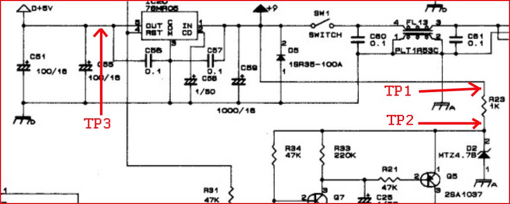

You really have to look at the +5 and +9 V test point with and with SW1 on and SW1 off.

I'm suspecting D5 or FL-13 (Choke) without any other information.

The is going to be real tough. On the upper right side of the schematic, there is something labeled JK1. Find it.
Follow it to the left and find the part labeled SW1. (Switch 1 or the power switch).
Keep following it to the left and locate the +9 and +5 volt items on the schematic.
Locate the component D5 on the circuit board. It may be the one your suspicious about. I can't see the label. D means diode and means the 5th diode.
Measure the voltage across that diode with the power switch on. Right now, don't worry about the polarity of your probes.
See if you can locate C80. (might be C60) and measure the voltage across it with the power switch on and off.

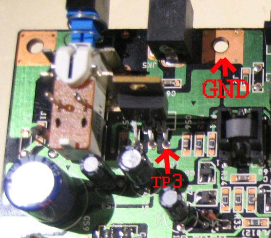

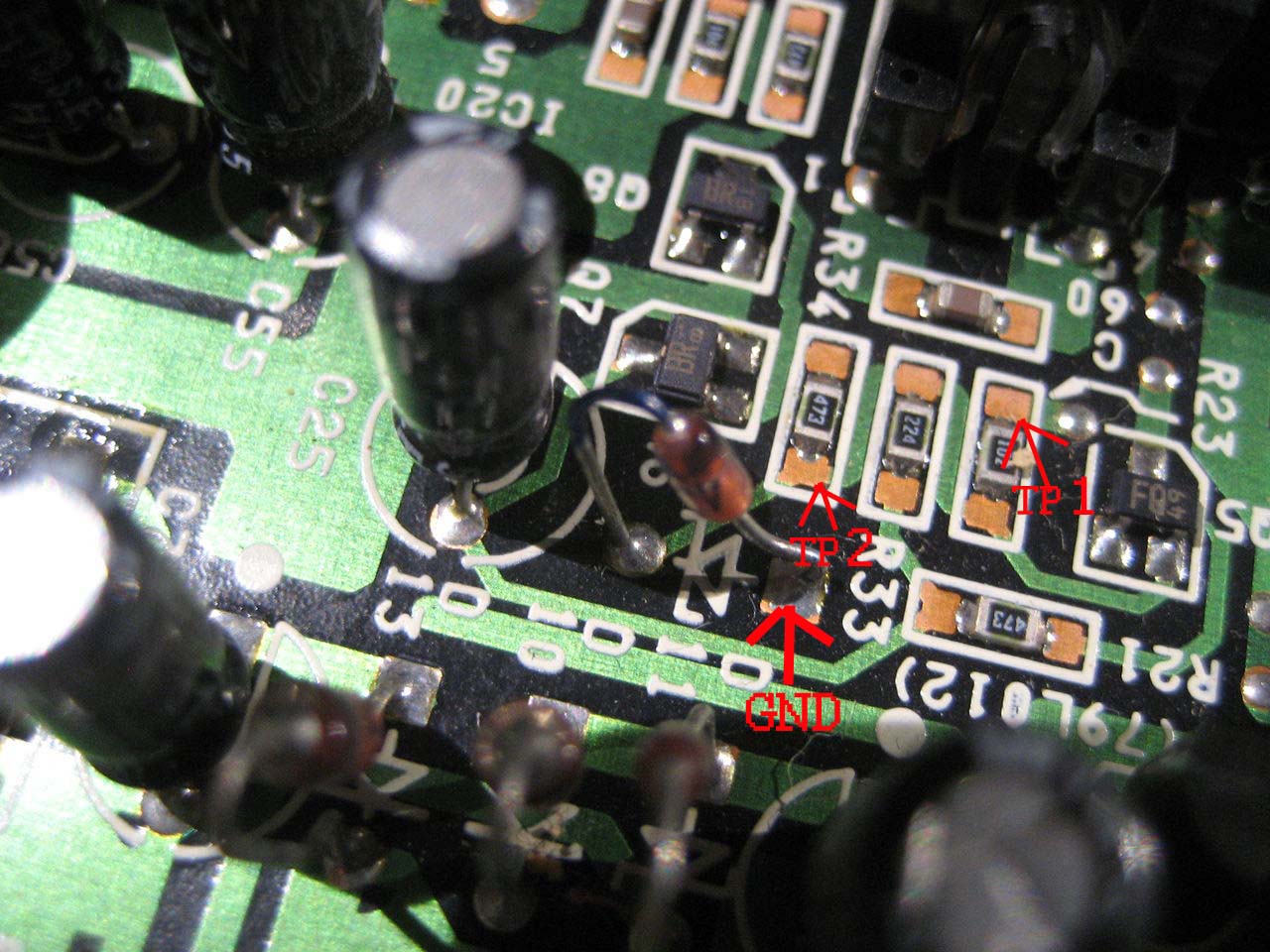

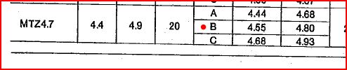

Once you have your external power supply situation corrected, could you provide the voltage levels at the 3 Test Points (TP) that are shown in the pics below? They would help judge the condition of the voltage regulating components.
