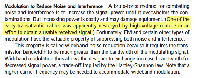

use of increased transmitter power to increase converage
PG1995
Active Member
Hi
Are cost and equipment failure the only reasons for not using too much power for a signal transmission in wired communication? By the way, what's that 'high-voltage rupture'? Increased signal power can also make the use of amplifiers etc. needless.
Note that broadcast transmitter is made up of radio transmitter equipment plus antenna.
Likewise, is this possible to use increased transmitter power to achieve greater coverage? This will make the use of repeaters etc. unnecessary.
Please help me with the queries above. Thank you.

What a badly written piece of text.
"Overwhelms the contaminations" jeez! what a drama queen!
"Increasing power is costly and may damage equipment"
Of course it is costly, use more energy, burn more fuel, pay more money.
The equipment will only be damaged if it is not correctly designed for the required power level.
"High voltage rupture" Yes one of the early cables did fail due to too much voltage being used to try and overcome the losses.
The voltage used was too high for the dielectric (insulation) in the cable, and so the insulation broke down.
Why didn't the idiot who wrote that text just say that!

Agreed. The text was taken from this book.
Once again, agreed. Actually one of the main problems I'm facing in this course is that I couldn't find a good book and the book being used is not good at all. Now I'm taking help from almost five books. One of the books Data Communication and Networking by Behrouz is good at explaining some basic concepts.
