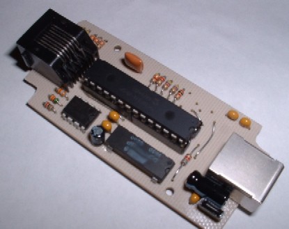

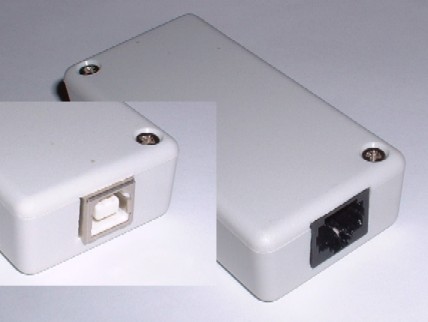

Here is ICD2 clone USB FT232RL based, uses virtual serial port, not as fast as real USB ICD2, but faster that serial, no power supply. Single sided board.
