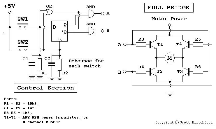

hi, I've posted before here but have now narrowed down my problem to the following:
With 2 switches, S1 and S2 positioned as so
S1 S2
How can I connect things up so that a motor operates fwds ONLY when the switches are pressed in the order S1-S2 i.e. so that if they are pressed in the order S2-S1 nothing happens ? Pls note that when I say press I mean the switches are HELD in the order S1-S2.

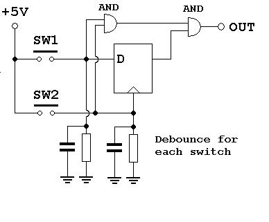

Ok,
So what you want is
S1: 0 -> 1 -> 1
S2: 0 -> 0 -> 1 = motor on, until either switch is released.
S1: 0 -> 0 -> 1
S2: 0 -> 1 -> 1 = nothing? Or the motor turning the other way?
Well, off the top of my head, you could try a simple 'D flipflop', with an AND gate. Both buttons (assuming they are 'momentary') would need debouncing, but a simple cap to ground would do. heres what 5 minutes in mspaint does for ya.
This is just the control part, not tested, probably won't work, just a simple idea. You could always use a microcontroller, but I thought logic is pretty cheap and easy to get hold of.
It shouldn't be hard to modify that for operating the motor the other way, but you'll need a half bridge driver, or a full bridge driver if you've only got a single powersupply.
Blueteeth.

Hi, firstly thanks ever so much for your reply as I am really at my wits end ! As you might have guessed I've bitten off a lot more than I can chew with this so this is why I come to the experts like yourself.
Basically I need this:
S1 THEN S2 pressed (and both held) :motor fwd until either switch is released.
S2 THEN S1 pressed (and both held) :motor rev until either switch is released.
This thing is (supposed to be) a directional sensor of sorts for controlling a DC motor. So with switch arrangement:
S1 S2
An object passing from left to right here hits (and holds as the object will stay in contact with the switches) S1 then S2 and so the motor goes FWDs.
Then an object passing from right to left hits and holds them in the order S2, S1 which REVERSES the polarity of the motor. With either direction, the motor should stop when BOTH switches are released.
Man, if you can solve this for me I'll send you some cash by paypal - that's how bad I need this now LOL. I'm serious though....
If you can provide me with a full working diagram (complete circuit with motor) for the above I'll pay you for your time.
well, the above circuit does what you want, just without the motor driver (google) and adding reverse just requires another 'AND' gate from the out of the S1/S2 AND gate and the inverted output of the flipflop
I'll draw up a better diagram soon, but I have no idea if it'll work, this is all guess work as I can't really be arsed to prototype something :D
Blueteeth.
Ps. When do you want the motor to stop? when BOTH switches are released or just when 'a' switch is released? basically is it AND or OR?
Ok, well here it is...
Let me know if it works. As for logic chips you'll need 3, thats quite a lot, maybe you could substitute the OR gate for a NPN transistor with two diodes on the base, because you only need one of those, and they come in DIP packages of 4 (I tihnk). SO that just leaves the D flipflop, and the AND gates, both of which should be readily available. Check here for part numbers:
http://www.kpsec.freeuk.com/components/cmos.htm
The full bridge motor drover is really basic, and probably not that good, using MOSFET's would give more current to the motor, but I've used power transistors before with success (they get hot even with smaller motors).
You *could* power the whole thing with the same powersupply, as CMOS works from 3-18 volts I believe, where as TTL (the 74** series) requires 5v.
Sorry if you know all of this, but that circuit is pretty basic, and you didn't mention microcontrollers, CPLD's or anything so I don't know what you'll understand.
Regards,
Blueteeth.
First of all sorry for the delay in replying but I wanted to make absolutely sure I had tested this to the best of my ability before posting. Secondly thanks for your help on this.
I'm having a small problem. The bridge circuit works 100% perfect and I tested this separately before doing anything else. Now, the problem I am experiencing is this:
Press S1 then S2 I get zero - no motor running
Press S2 motor runs clockwise but stops as soon as I hit S1
There's obviously a problem somewhere but I can't figure it out. I'm powering the whole thing from one 9V battery (the motor and the control section). I made sure I got the correct CMOS chips also but just can't seem to make this work. Any help would be greatly appreciated and if you leave me your paypal ID I will send some cash to cover your time.
Thanks again
Thanks again
OOoo, hi :D
Well looking over the circuit, it appears I made a couple of mistakes, sorry. Yes, the bridge is a tried and tested simple method for making a motor run either way on a single supply (not a dual +, GND, -supply).
As for the control circuit. A little explaination.....
The 'flip flop' part, I'm quite pleased with. S1 is the input to it, and S2 provides a clock. So, because both buttons are normally open...and pulled to ground, they are '0'. If you pressed S2 THEN S1, you are clocking in a '0' to the flip flop, then changing its input...so the output of the flipflop is '0', because the FF only reads the input when the clock goes from low to high. Any changes made to the input (S1) make no difference whatsoever unless S2 is pressed AFTER S1. So for that part at least, its all good.
Now, the problem arises with the 'OR' part. The output of the flipflop is only part of the problem as its output stays on if you pressed S1, then S2. The only way to change the output is to pressed S2 without S1 being pressed before, (so, S1 is open, it shows '0' to the input of the FF, and you clock that in with S2). I used an OR gate so that only when BOTH switches are released from a press, does it provice a '0', and therefore, when anded with the FF output (normal or inverted) turns this off.
There-in lies the problem though. Because its an 'OR', pressing either or both the switches makes the output of the OR gate '1', and therefore, because this is AND'd withthe flipflops output, whatever state the FF is in, sends the motor running. Now, because the motor runs in either direction, depending on the state of the flipflops output, if it isn't anded with something (like the output of our OR gate) then the motor will run continuously, and we can only change the direction if it.
Just wanted to get an explaination in first, circuit on its way. As I said, rough idea, not tested, and I made several mistakes :D
Blueteeth (buriedcode)
