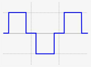

Can I use 12V modified square wave 50Hz circuit to drive above UPS transformers using Full bridge or Push pull circuit?

The transformer in a typical modified sinewave UPS does not directly make the output voltage. It makes a single DC rail that is the peak output voltage.
4 mosfets in a full bridge configuration then are switched on in timed sequence to create the positive. zero, negative, zero, repeat, output waveform.
