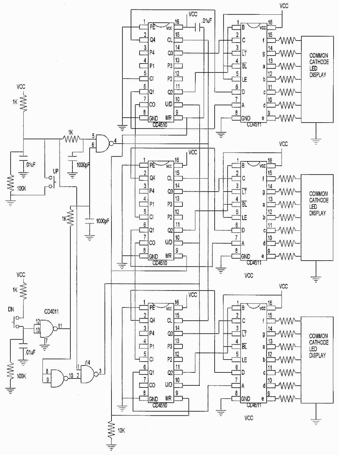

i ve got a small problem in that im struggling to get a circuit that counts up and down using a 555, 4510, and 4511 with a seven segment display to work. does annyone have a clear circuit diagram that could help. if so id be much appreciated, cheers matt
basically the idea of the circuit that i have to make is a clock in and out for a bouncer. so basically a push button needs to be pushed to clock a person and the counter needs to go up, and when a person comes out they have to be clocked out, ie the counter needs to count down. its basically for fire safety. i have decided to use 3 seven segemenen displays, ie so that the counter can go up to 999.
We could help you better if you post a copy of your circuit. You may be having problems with contact bounce. Switch contacts bounce (ie. open and close several times rapidly when operated). So your counter will count these hence incrementing more than once per button push.

I don't know why you have the 555 timer, check out this circuit. I think it works, if you build it and have problems, let me know.

You might use a CD40110 Up/Down counter. It directly drives a 7-segment display so you need just one chip per digit.
You will, of course, need a contact debounce circuit to drive the Up/Down inputs as mentioned. A Google of "debounce circuits" will turn up many.
