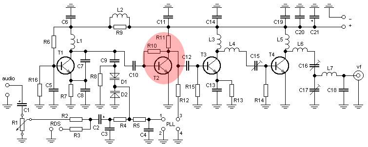

This is a basic FM transmitter circuit. I made lots of basic transmitters as an experiment. This one has class-C driver and class-c output amplifiers made by T3 and T4. T1 is an oscillator but I think T2 is not 'RF amplifier'. T3 is class c amp so I think T2 is related to impedance matching stage necessary for T3 amp, Isn't it?
Circuit and details are here- https://pira.cz/entx2.htm
If it is impedance matching stage, then should we need to use UHF transistor- 'BFR91A' as designer? What happens if I used 2N4401 (Ic=600mA) VHF transistor? 2N4401 has 250MHz fT. I think I can use, can't I?

It's a simple amplifier, both boosting the output of the oscillator, and also isolating it from the following stages - including the PLL circuit, which will probably require a higher level than from the oscillator direct.
Try the transistor and see, but it's not got a very high fT so it's gain is likely to be low.
When a transistor has an fT at 250MHz like a 2N4401 then at 250MHz its AC current gain is 1 like a piece of wire. At 125MHz then its AC current gain is only 2 times.
When a transistor has an fT at 6GHz like a BFR91A then at 3GHz its AC current gain is 2, at 750kHz its AC current gain is 8 and at 93.75MHz its AC current gain is 64 times.
But is it an RF amplifier where transistor biased with only resistors?
If a transistor does not have much current gain at a certain frequency then it does not amplify much.
A class-A amplifier is biased, a class-C amplifier is not biased.
T2 is biased with R10 as a class-A amplifier. T3 and T4 are not biased so they are class-C amplifiers.

Then this 3 watt machine will produce just around 1 watt due to low gain transistors, isn't it?
The 2N2219 is very old and is difficult to cool. I would never use one.
I did not look at the datasheets for the 2N3866 and 2N3553 because a high power FM transmitter is illegal without a licence.

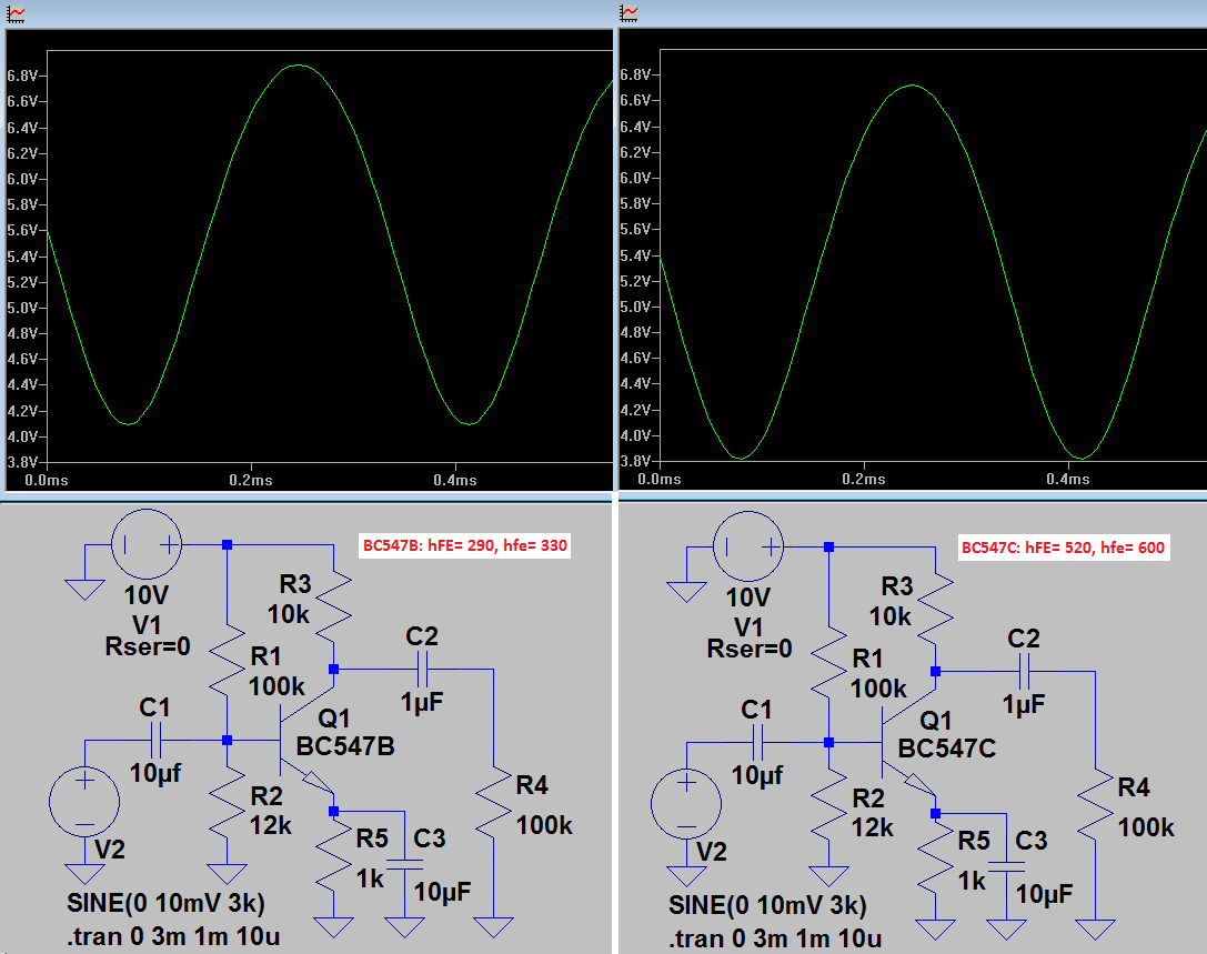

And now basic question about hFE vs hfe- Can we say more DC current gain transistor has more AC gain too? Can we say 147 hFE transistor can amplify more AC signal than 97 hFE transistor can?
Did you know that hFE is DC current gain and hfe is AC current gain? They have only a small effect on voltage gain.
The one with a higher hfe will deliver more signal to a lower impedance if it has the same input power as one with a lower hfe.
Here is a simulation using a medium gain BC547B and a high gain BC547C. The numbers are from the datasheet so I hope the simulation software is accurate. The DC is shifted a little due to the different hFE but their amplification is almost the same.
The signals are distorted because the output levels are fairly high and there is no negative feedback.
EDIT: The outputs are the collectors.
