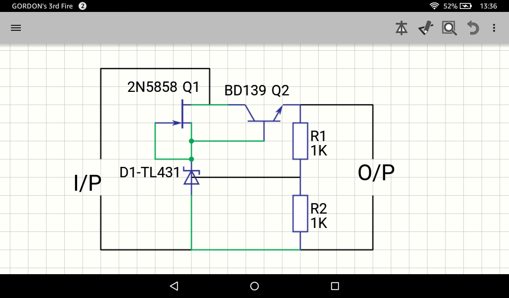

I built a simple voltage regulator, see attached, using a tl431 fed by a jfet wired as a current source and an npn buffer transistor.
I carried measurements of output resistance using the formula; Rout = ∆V/∆I. With loads between 0 and 125mA the output resistance was in fact negative, that is the output voltage actually increased ( albeit marginally ) as more current was drawn. Above 125mA it started to behave as would've been expected, that is a drop in output voltage under increasing current draw.
Can anyone explain this behaviour? I'm concerned that negative resistance could cause spurious oscillations.

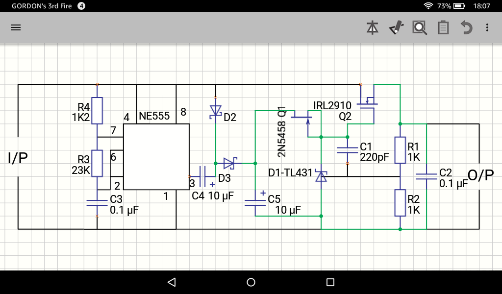

The problem was due to spurious oscillations, this was fixed with a 220pF cap across the cathode and adjust terminals of the TL431.
I decided to try it with an nmosfet. I used a 555 based voltage doubler for the higher drive voltage required. The circuit outperformed the original in most respects. Very low dropout. Output resistance of 14 milliohms and good regulation. The only downside was a little extra noise from the voltage doubler.
See attached schematic
TL431 requires up to 1mA minimum load to remain in regulation, and this requirement is not met . You d not need a voltage doubler and there are single component LDO's with better characteristics.
Since increasing transistor load causes Zener bias to be diminished, you might want to add 5k to the Zener output. This may prevent the oscillation as well in the 1st case.

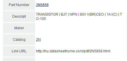

Is there an error in Q1 part number on your schematic, because I'm pretty sure a 2N5858 is an old high voltage bipolar juction transistor?
Yeah, sorry the jfet was a 2n5458.
I have amended this error in the schematic on post #4
