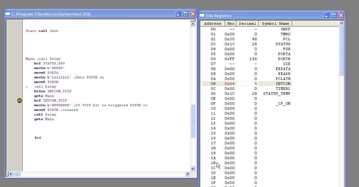

Your code is looking for the timer0 overflow by two means, by the ISR and direcly in your code by testing the overflow flag.
If you run your code in Sim it never seems to get either overflow, but if you remove your Delay routine you can see it clearly is generating the overflow.
Not sure yet why the ISR is not being inovked, but your code does need a lot of work.
You might find this link / delay routines of use

You will be hard pressed to see / make use of timer 0 on a scope - try to use the Mplab Debuggers, Mplab Sim with breakpoints in your code as I did in that screenshot, it also allows you to single step through each line of code.
The problem with your variables is their addresses, would suggest you always specify all eight bits doing it that way, it is however generally more common to address them in hex.
Would also suggest against using timer1 and timer2 as names for those variables as they could cause confusion with the Pic timer1 and timer2 .
your code
w_temp EQU b'1010'
timer1 EQU b'1011'
timer2 EQU b'1100'
status_temp EQU b'1101'
for clarity try
= w_temp EQU 0x0A
but -
If you look at the pic18f84a datasheet, memory section, you will see that the available user ram space starts at 0x0C, so you have been trying to overwite the systems variables - perhaps why things are not working.
