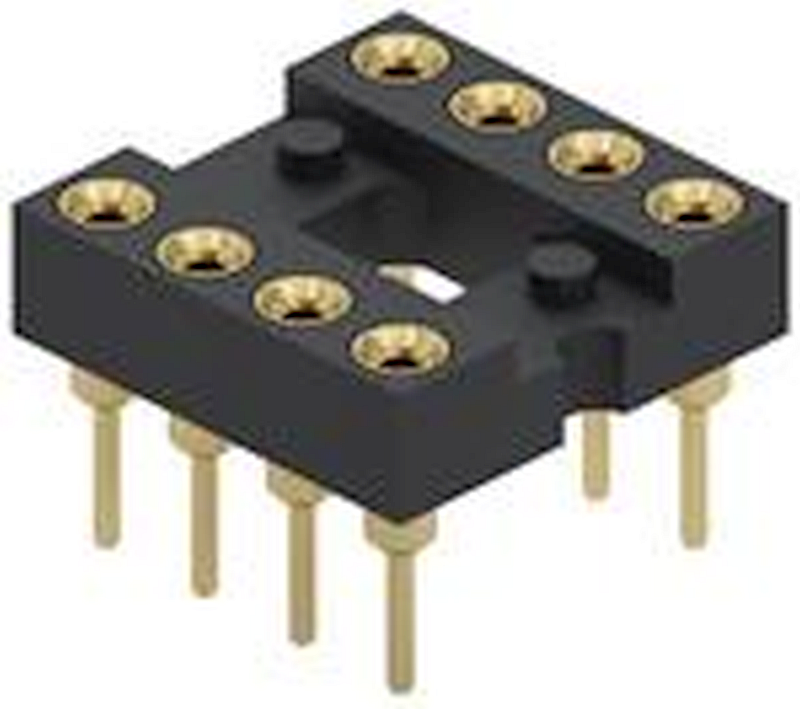

Anyone know if you can get maxims umax to dil adaptors so I can get a 8 pin umax device on breadboard?
8-Pin SO/uMAX to Dip 8
https://www.proto-advantage.com/store/product_info.php?products_id=2200026
Apply solder paste and use mini-toaster oven or other method, to match recommended solder profile use a thermocouple.
Alternatively buy an extra chip and place on DIP socket with a hot glue dot then insert resistors into socket , cut bend and solder leads to chip. ( not to scale) Or similar method....
Custom sockets for ATE are expensive. This way is cheap.
