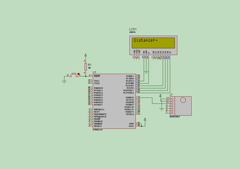

hey i got working on your requirement and here are the results. is this enough?
View attachment ezo sensor electro tech.zip

for two sensors you can either connect then in some way that one would'nt communicate with the controller at a time. or use a small signal diode for communicating. or you can make a software serial and then interface, its upto you.
Hey magvitron...
the code u snt me is showing error which displaying data on lcd....
tell me what circuitary or programmind i changed to get correct circuitary.....:(
