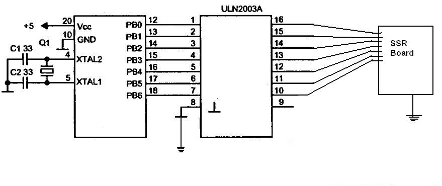

im working on a project that will control 20 SSRs operating at 24 volts.
the relay board has a single input for the 24volt relay control circuit, and only require a short between the ground and the control pin for the selected relay. 24 volts will flow thought this short. i want to allow a microcontroller to run these relays i originally planned to use simple switching transistors to control each of the lines, but i wanted to use an IC as it would provide and neater circuit and less components.
Could i use the ULN2003 to contor the lines by just connecting the control pin for the the relay to the control pin on the uln chip.
Any help or ideas would be appriciated, i attached a image detailing the way i think it would be wired..

It should work ok, If the relays don't have a transcient protection diode across the coils I would connect the common pin of the ULN2003 to +24 so the internal diodes are the protection diodes.
that is exactly what the uln2003 is for. just tie off the common pin to the 24V supply and you are off to the races.
well the problem i saw was that the ssr board uses a common ground and has its own power hook up,
so can the uln provide me with the short needed to trigger the solid state relays on this board

Since your relays are solid state (no inductor), then you don't need to connect the common pin to +24. Your design will work fine.
I bought the board and relays on ebay, i was looking to get some logic level relays but there 5 to 10 dollars a piece, i only paid 10 dollars for 20 relays and the board, i figure the buffer i need to make is well worth the savings. :)

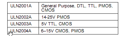

The ULN2003 can be driven by logic voltages to provide an earth to the target circuit when a logic High is present at the input.
You must connect Pin 9 of the ULN2003 to the positive supply of the relay to shunt back emf
Why don't you look at the datasheet for the ULN2003A?
It tells you all about it.
Of course it can be driven directly from an output of a micro-controller like a PIC.
See if your micro-controller has an output current of at least 125uA.
But a ULN2003 has a voltage loss of about 0.8V at the low current for a relay so the 5V relay might not work.

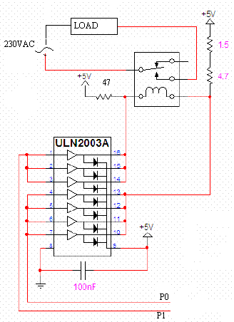

Hello There,
Yes I have checked the data sheet, but i am not confident that if i connect the MSC1200 port pins directly to the ULN2003A base (input) pins then the MSC port pins will be able to drive the ULN2003A. I have attached part of circuit diagram with this reply, hope this will give you clear picture and you will be in better position to help me out. The only thing I am intrested to know is that is this circuit OK? and if i directly connect the MCU pins to ULN2003A pins will MCU pins be able to drive the ULN2003A? or i have to pull up the p0 and p1 in order to drive the ULN2003A.
Many thanks in advance, looking forward to your suggestions and help.
Best regards
Asif

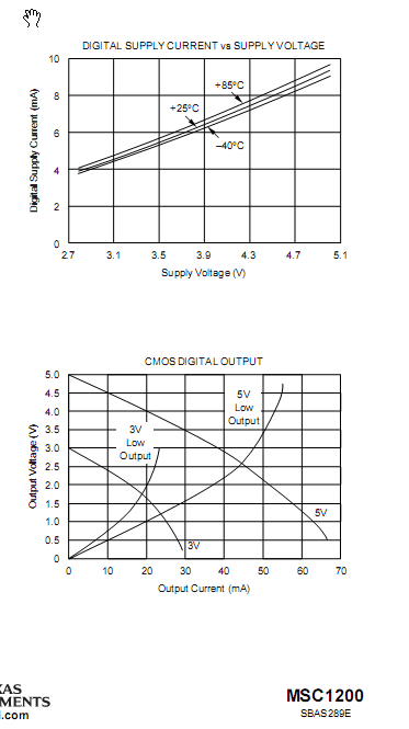

look at these images.
Why have you connected the ULN drivers in parallel.?
What is the current or resistance of the relay coil.?

Hello,
I am using TYCO ELECTRONICS PE014F05 5V SPCO PCB relay. https://www.electro-tech-online.com/custompdfs/2009/01/63899.pdf
Coil resistance is 125 OHM (datasheet) and verified by multimeter. coil power is 200mW. why i connect ULN drivers in parallel is to increase the current to the coil. The relay is a Single Pole Change Over relay ie if coil power is removed it maintain its last state and in my circuit i just have to power the relay for 30ms to 40ms. But if you have any better idea plz do tell me. Other main factor i am afraid of is that if i directly connect MSC1200 port pins to ULN will that work or i have to pull up the MCU pins in order to make circuit working. Any suggestion/ideas/help??????
