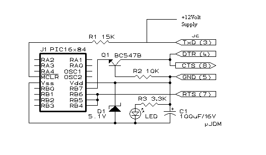

I was built uJDM programmer and it won't work because my desktop serial supply is +8.3V only, not enough on burning process. So i get an idea to boost up the voltage by given a supply +12V or +6V (depend on serial voltage). I not try yet, just i want to share and get some idea or suggestion from all electro-tech-online friend... :lol: Here i attach the modification cct...
At that you're feeding the 12V directly into the Txd pin of the serial port, which is probably going to blow it!.
If you search the net for 'jdm programmer' you will find plenty of sites with the JDM programmer modified for an external supply.

Nigel: if i put voltage regulator to boost the TxD voltage can or not?

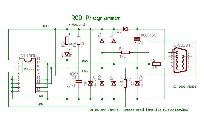

Nigel: If my serial port just reading 8.3V, so i can't built up for RCD programmer (cct shows below)...that true??

Thank nigel for your advice... actually my RCD programmer was work but only with winpic software (icprog--failed)... I was found that my serial port is not enabled on bios program...
