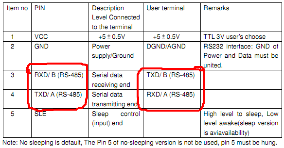

Checking with your datasheet, I expect you have the RS232 version of the module.
It reads as though the RS232 levels are TTL ie; +5V /0V, but I cannot be sure of the 'sense' of the levels.??
EDIT:
From the PIC to PC you require that MAX232 also from PC to PIC you require that MAX232, is that the way have them connected. ie; both TX and RX from the PIC to PC via a MAX232
The JZ871 is is using rs485 the pc you use rs 232 could you post how you have this hooked up

Eric the JZ871 is is using rs485 its high going low he has to invert his transmission

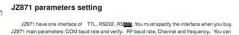

I'm going by the datasheet lloydi12345 posted
JZ871 have one interface of TTL、RS232、RS485, You must specify the interface when you buy. Found that in the datasheet
This is the way I read it.

Thank you ericgibbs and be80be. I'm so thankful to have two guys willing to help on solving my problem. Although I'm quite confused with table 1 the circuit for transmission works now. I had a trial and error to figure out which pin is right to achieve a successful transmission. I figured out that the problem is on 1st side, the RF Transceiver's tx pin is loose. It's not touching the breadboard. Sorry for the headache I gave to the two of you. Next time I'll encounter this problem, I'll always go for hardware connections first than going right away to my program code. Now we can show this to our exhibit which is 3 weeks away. Thank you again :)
