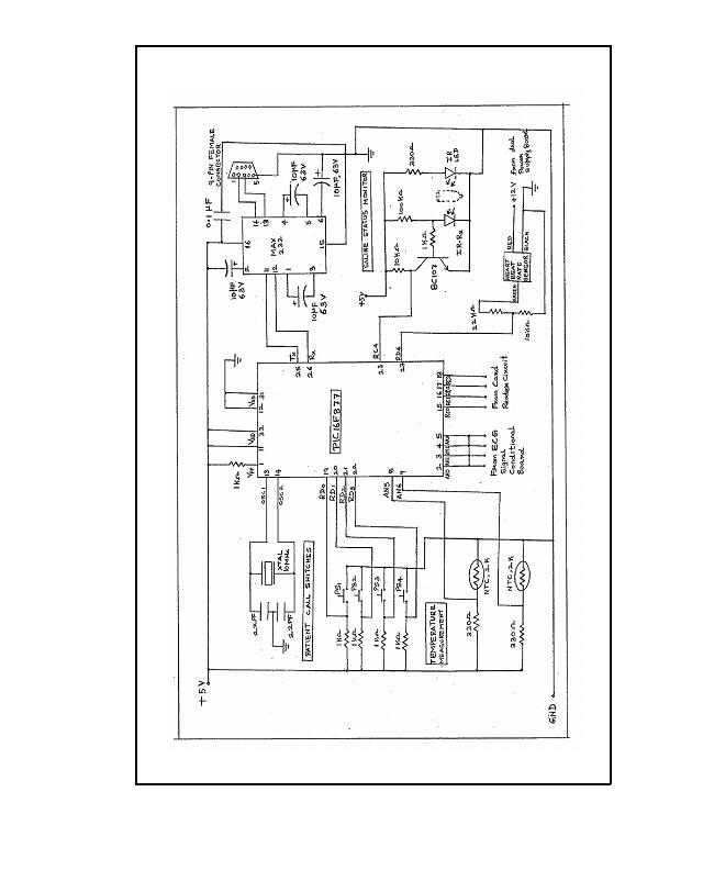

Can you post a schematic of your device. Have you built it yet?
PS your PK2 can debug the 16F877 this may help with working the bugs out.
I have not yet completed it . i need some more time , because i have to find photoelectric sensors , ecg electrodes . I am attaching the schematic of the circuit , its not in eletronic workbench its drawn by hand.

You've only got a week to finish the schematic (post it as we can help spot errors like missing bypass caps etc) get parts, program, built and test it. Good luck.
Its ok blueroom , i got to hex file and ERIC helped me in enabling the pins. I m posting the schematic. I hope programming the PIC is solved , still i have to send it to the PIC . i bought pickit 2 , but i dont know how to proceed, how to send the hex file to the PIC. if you can help me on that.

Well you will need 0.1uF decoupling caps near the VDD, VSS pins. 16V caps will work with the MAX232.
You have to connect the PK2 to VPP, VDD, VSS, PGC & PGD it will also debug if you leave it connected.
