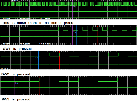

MrRb you hit the nail on the head that's the problem Inverting really helps and I have done code like your saying a form of manchester it works fine as long as the keying is long enough to keep the receiver from picking up noise.

Here a pic there labeled first one noise second one is what turned on the lights third one turn them off it worked fine
Guess attachments still don't work
