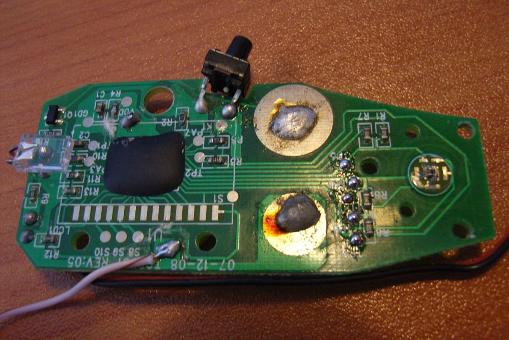

Does anyone know how to get the pressure data from one of these cheap tyre pressure sensors?

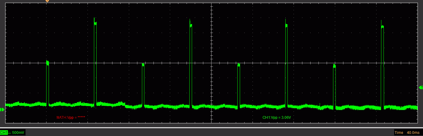

The sensor is a bare silicon die on the PCB inside the device. There's a number of test points on the PCB, and the only one that appears to be useful is one that has pulses that alternate in amplitude. There are other TPs that have a stream of small pulses. All pulses on different TPs are in sync.
I captured the level of the pulses and coded them as '1' for a large pulse and '0' for a small pulse.
0101010101010101010101010101010101011101011101010101011101011101010111011111010101111111011111010101111101011111111111111111111111111111111111111111111111111111111111111111111111111111111111111111111111111111111111111111111111111111111111111111111111111111111111111111111111111111111111111111111101110111111101010111011111011101011111011111111111111111111101010101011101010101010101010101010101010101010101010101010101010101010101010
I further coded this so that "01" becomes '0' and "11" becomes '1' in the hope that this turned up some sensible information.
000000000000000000100100000100100010110001110110001100111111111111111111111111111111111111111111111111111111111111111111111111111111111111111111111101011100010110100110111111111100000100000000000000000000000000000000#
The above is recorded over 25 seconds; when the device is started, there is no pressure applied to the sensor (which causes the string of "01010101"s). Then a pressure of 15-30 psi is applied, and may be removed before the end of the recording.

I don't have a decent camera on hand, so some very poor photos are attached.
Mr RB, the pulse rate is 20 Hz and every second pulse is high (10 Hz bitrate equivalent). This means that for 99.5 PSI (from "specs" linked below) you'd need a minimum of 200 counts, which would take 20 seconds to receive a single reading. While I agree with you that I need to record the actual displayed pressure, I don't think the duty cycle / number of pulses high will deliver this information.

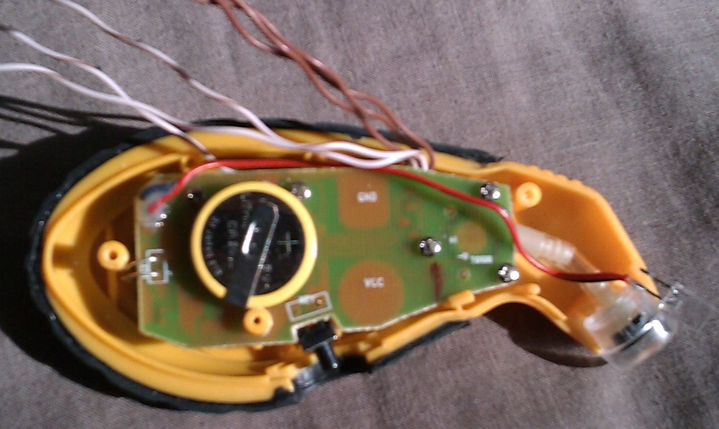

I wish you had clearer photos.
The only easy option is to decode the signal coming out of the sensor, but if the bitstream is too slow that won't give you enough resolution. Do we know what is happening at the sensor? There seem to be a lot of wires (tracks) going from the micro to the sensor.

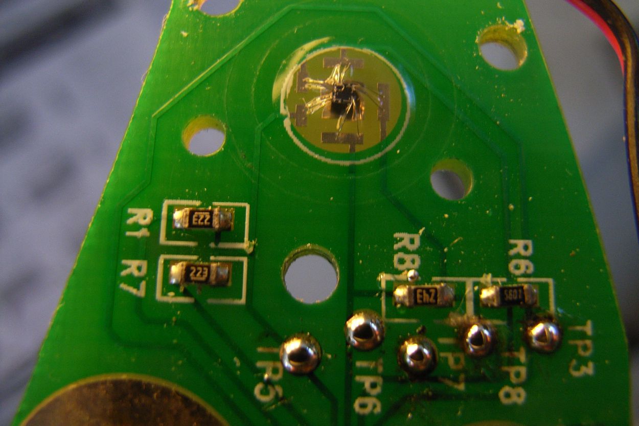

Here are some better photos.

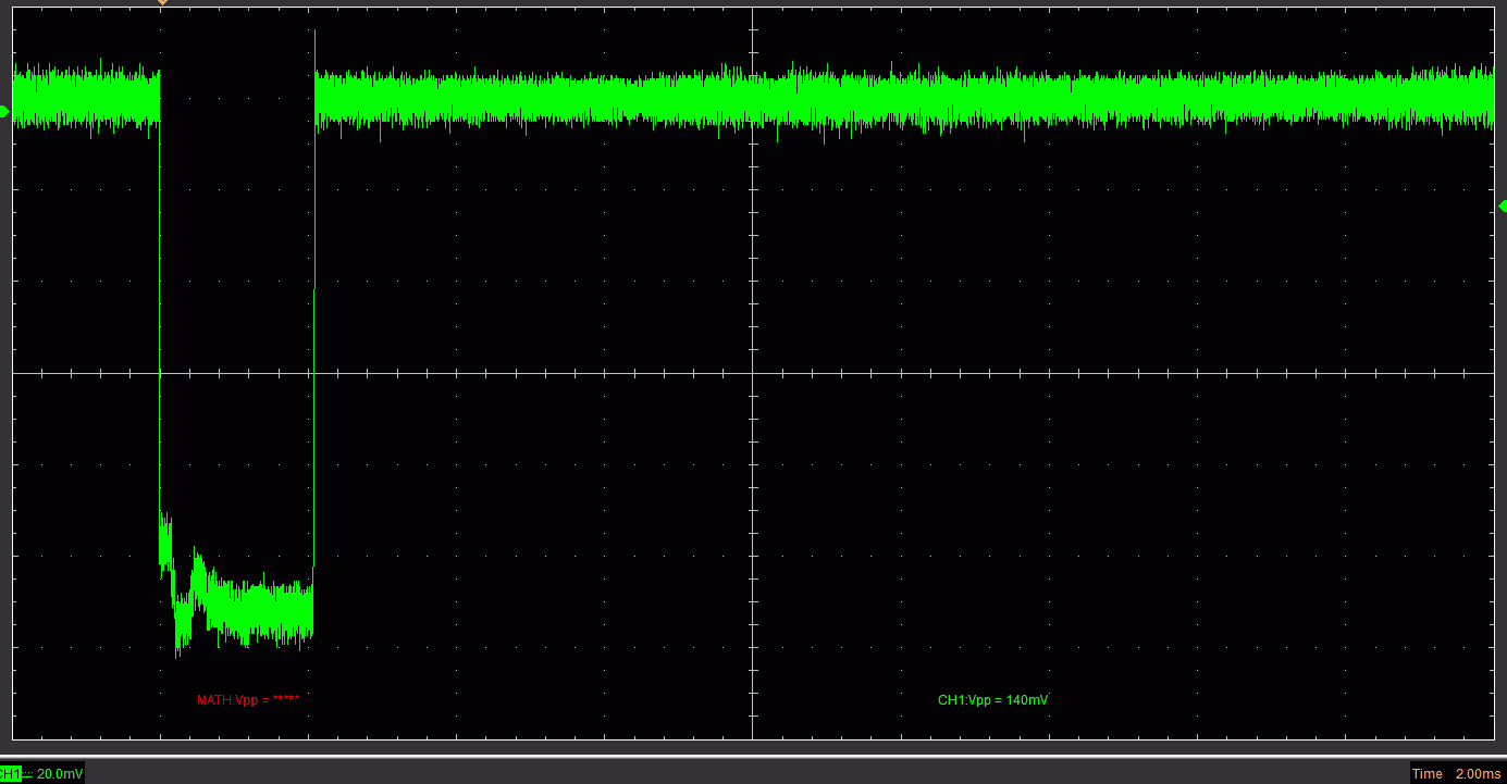

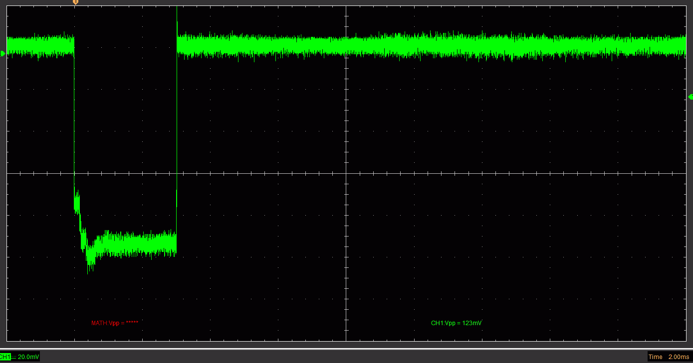

Appears that the sensor is wired as a 4 terminal device. The response rate seems to be less than half a second, so that would kinda rule out digital coding and might lead one to believe that the signal is actually analogue. The sensor could be a bridge sensor, with the micro is providing pulses (reduce power consumption) of supply power for 2ms (sufficient time for ADC to acquire a stable signal).
I didn't see any apparently valid value between any two test points, but I probably made a mistake or simply the signal is too small to see against the noise of the DSO2250 oscilloscope. This, and the fact that the pulse stream appeared to be encoded, made me believe it possible for digital encoding.
I guess that might mean TP7 could be the [dual] drive negative connection, TP6 the positive drive, and TP8 and TP5 are the bridge outputs...
ref Figure 1 of https://www.maximintegrated.com/app-notes/index.mvp/id/871 with the extraneous connection removed
EDIT: Seems to be a possibility. Measured peak differential voltage with 0, 10-15 and ~30 psi (based on bike pump gauge, not digital gauge) are 127, 134 and 140 mV respectively. So it's around 433 uV/psi.

Looks a little bit like a motorola mpx series pressure sensor, which are analogue, they have 2 pins for power and the other 2 are differential o/p's, + and -, you can connect these to a differential op amp circuit to amplify the o/p.
Yeah I never thought it was a digital sensor, I thought it was a pulsed conversion process with an analogue sensor.
It's a good bet that it is an analogue bridge sensor as you and dr_pepper thought. Now of course if you interface to just the sensor then the rest of the unit can be discarded, it becomes a $4 pressure sensor.
